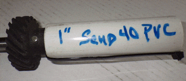

It's possible to re-orient the intermediate shaft with a large screw driver. I've done it many times.
A short length of PVC and some zip ties to adjust grip can aid in removal of the shaft if needed.
