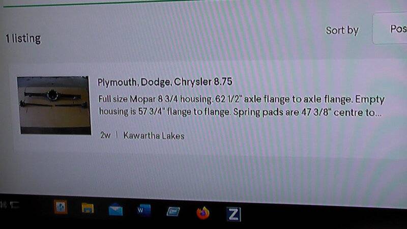

AS you can see in this pic the measurements from what i have read it will fit my 71, but need to know, can someone say yes or no. thanks again.

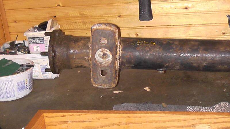

OK got the 8 3/4 housing, but there are 2 locating holes and 1 big hole. in the past with a body rear ends i have had just 1 hole in the perches what gives.witch do i use very sure the big hole is not what i use, or am i going to have to get new perches.
I think that perch is for the iso (rubber mount) suspensions. My '73 had perches like that. When I changed to Cal Tracs, I had to make a disk that fit on the spring bolt to center it in the large hole so I could do away with the rubber glide stuff.
