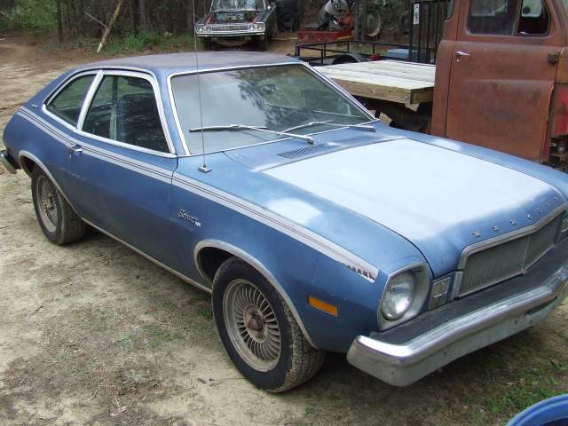

After literally years of trying to get some kinda Mopar goin to no avail, struggling with depression and all of my disability related issues, I finally realized they are simply too expensive for me right now. So......I got a Ford product. I thought about a long time before I did it. My thought is, if I can attach something to the 5.0 Fox Mustang movement, it will be dirt cheap to build. No, it's not a Fox body, but I am basically putting a Mustang (Explorer engine) in it. So I thought I might share it with yall, if you're interested. If not, that's cool too.

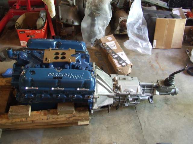

Ok. Here it is. A 76 model Mercury Bobcat. I am putting a 1999 5.0 Explorer engine in it. It is the GT40P engine. Has the best heads Ford ever used on the 302. Almost ready to stab the engine and trans in the car. It's a world class T5 5speed transmission. I have already swapped in a Ford 8" rear end with 3.40 gears. It's essentially just a small 9". Looks just the same but is a tad smaller. Had Oregon Cam do a custom grind off the stock Explorer core. .447/.506 218/224 @ .050 on a 110. Hydraulic roller. Desktop Dyno says close to 300 HP and over 340 LB FT of torque. Should be snappy pushin around less than 2500 pounds.

I bet that car is a hoot. I am doing this for a couple of reasons. First, to keep me in the hobby. I don't care what anybody says, Mopars are costly in comparison to Fords and Chevys. Secondly, I did a V8 Pinto about 30 years ago when I was a kid. It was a real hack job. I cut that car to pieces. Kinda always wanted to redeem myself. This car is a factory P/S, manual disc brake, A/C auto. So far, I've swapped in the 8" rear end, swapped in manual pedals, got the engine built, the transmission bolted onto the engine and the engine bay cleaned and painted. I need to patch a hole on the passenger's side fender well where the battery was, and get the HVAC box out to replace the heater core and inspect the evaporator. Once I get that done, I am gonna stab the engine and trans in. The 74 and up cars are a complete total bolt in swap for a small block, as they share the same chassis as the rustang II. I think the only reason Ford never offered a V8 in these is because they wouldda upstaged the rustang. ......and they certainly would have. Hopefully I will be driving it by the end of the Summer if not before.

Holy crap. If I move the shifter forward 5", it will be under the dash. It already is gonna be a little forward from stock. Some of the guys say sometimes you need to trim the front of the shifter hole and sometimes not. Kinda cool too, because they all used the same size hole for manual or auto, so I MAY not have to cut at all. We'll see.
