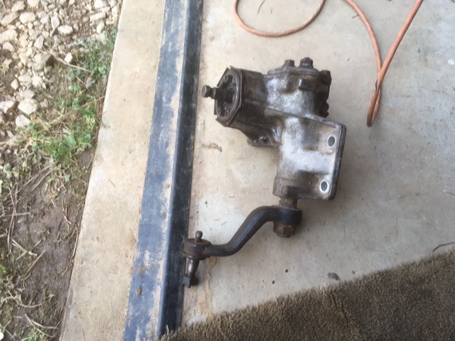

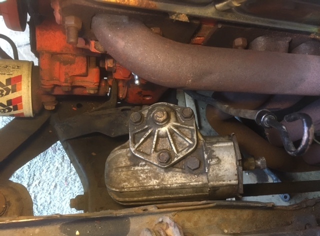

I installed an alunimum manual steering box from a 66 B body. I had to flip the center link as it was hitting the oil pan. Also the pitman arm is hitting the lower control arm on hard left. Car is on jack stands. I have 3 3/4 turns but it won't turn to the left as far so I'm going to grind a small notch in the pitman arm. Should give me a bit more. Maybe a tiny bit off the control arm as well. Saved 20 pounds plus the pump.

Pretty much all the 65-71 manual boxes where aluminum. The V8 cars had a bigger sector shaft & bigger bearings. Flaming River makes a steel box with a quicker ratio. It's EXPEN$IVE though.

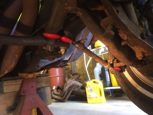

Now that the aluminum steering box is in I remove the tie rods & cleaned them up. Checked them to make sure they where still tight & installed these super HIPO red tie Rod boots that should cut the ET's by a tenth.

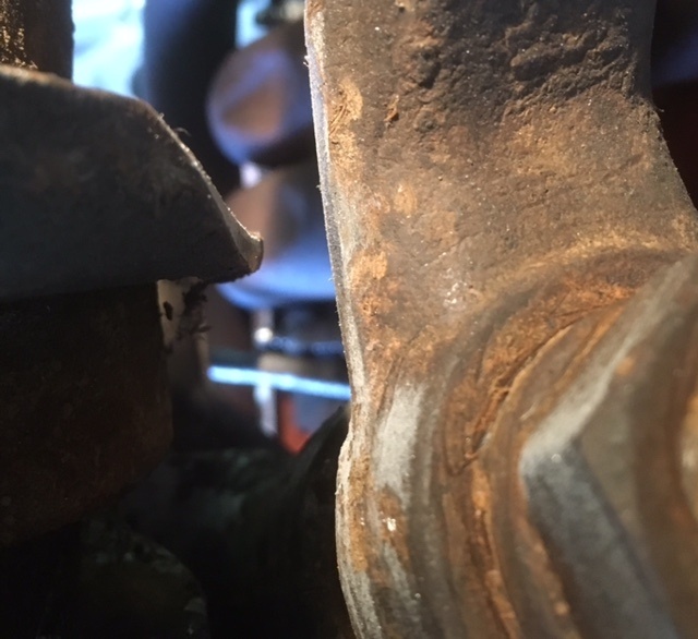

Then I addressed the issue of the pitman arm hitting the left lower control arm on full left. I had 3 3/4 turns lock to lock. It clearly wasen't turning as far to the left. So I got my grinder & file out & shaved 1/16 off the pitman & an unmeasurable amount off the control arm. It worked as now I have 4 1/2 turns lock to lock. It still hits but now it looks like the wheels turn the same amount in both directions.

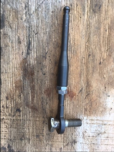

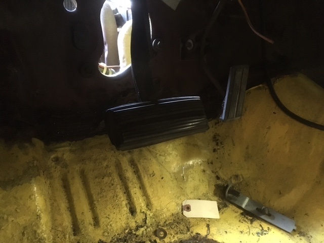

Then on the the manual master cylinder. I bought an adapter & it didn't fit so I had to drill 2 holes in the firewall brake master bulkhead & oval the hole the push rod go's through. Master mocked up & the adjustable push rod I bought was WAY to long so I cut it down & cut some more threads on the other end & now it fits nicely & the brake pedal is in a good position. I still have adjustability in either direction. Next will be the line lock control. Its comming right along nicely
