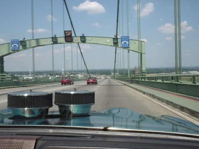

I just look for the spot on the hood where the carb stud hits :rolleyes: .......usually about 1.5" of center
