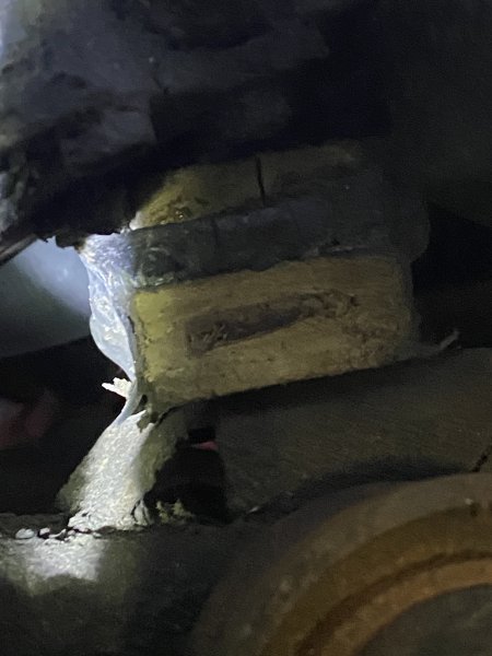

In exploring this purchase I found out all of the prior owners only knew how to apply wax , chrome polish and vacuum.
The oil looked like mud, The engine was twisted up so far the oil pan was bumping up against the supports. The motor mounts were, as seen in picture 3, ( plywood with rubber sandwiched between it)
and all the usual items unmaintained.

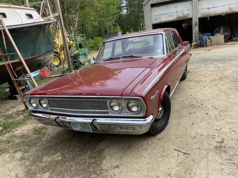

Welcome to the site. That's a beauty. It sounds like it needs some love. Stick around and we can help. Used parts can be had with a wanted ad here. Start out in the Marketplace forums. Lot's of needed parts change hands here. There are a lot of places that sell repop parts for these cars. Mega Parts USA is a place I go first.

That's a great color to wax for sure!

Welcome to FBBO from Ontario. Nice Coronet. The automatic transmission behind youd slant 6 would be a Torqueflight 904. Although it is shifted by a column mounted lever, it is still a cable operated transmission, same as the previous year's push button piece. These transmissions have a second rear oil pump, so require the filter with 2 outlet holes. A&A Transmissions, near Indy, is a good supplier of Mopar transmission parts.

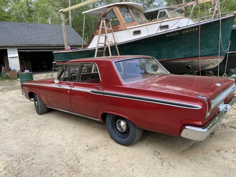

Love the tail lights on them '65s. Nice looking car.

Welcome from the central coast of Cal. I too have a 65. It's a 500 2 door hardtop. Looks like yours is the same color mine started out with, Ruby Red Poly. It's currently pork chop[ Porsche] red but am going to put it back to the RRP or something close. I will overlook your past indiscretions being a GM guy as will others I'm sure.:lol:. I don't have much room to talk though since I did own a 61 Catalina for about 6 months. Bought it as an investment and did well with it.
Welcome to the forum! Great looking car you have. The Slant Six is about impossible to kill and are great engines.
That's a good looking car.
