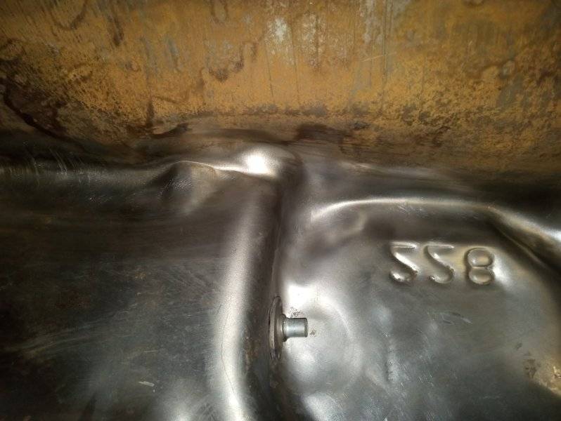

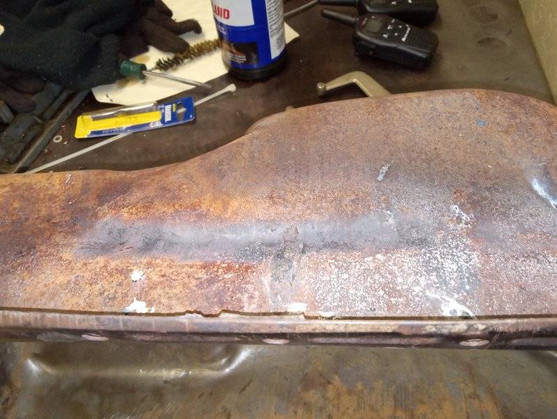

Anywho...when I got back to the shop to pickup the parts I was in shock...it looks like that oil pan had been on the Key bridge in Baltimore... I new it had a big dent in the bottom that I needed to rework. But one side is literally smashed.
Looks like it was on top of that bridge and landed in Chesapeake Bay!
So I'll see if I can beat it into submission like my ex did to me on our first date.

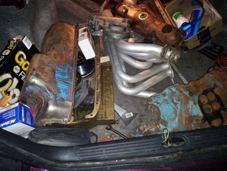

PS... Note the photo of the trunk of my daily driver....
Mopar race headers, race oil pans, Fluidamper, pulleys etc all going to South Dakota this week.

Yup, looks like someone shoved a floor jack in a little deep.
Must have been dropped...however the pickup was not bent.
You can't really see the big V that's a long one side of the pan. The pan came off easy so it will seal ok.
I'm going to try to find my ancient porta power, clamp the pan to my bench and try to push that dent outta the side.
This is a '73 engine but was installed in an M body IIRC. I hope the pan fits my '65... If not I have big hammers.
Get another pan. They're cheap enough to not worry if you get a good seal.
I hate to toss things that can be repaired.
I can get a new China pan for $68... But that's less money for the other stuff I need.
And that's 68% of what I paid for the whole engine!
The pan rail is straight and flat. No reason why it won't seal.

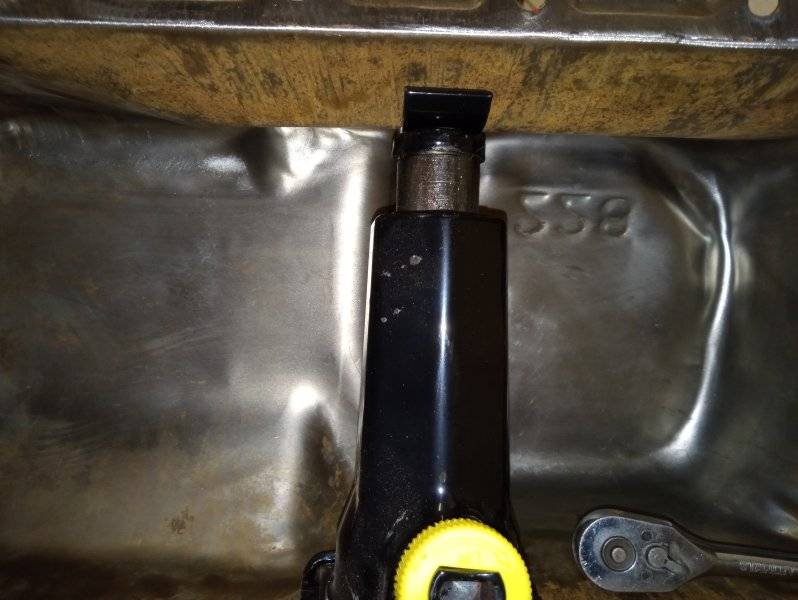

Anywho I decided to tackle the smashed up oil pan.

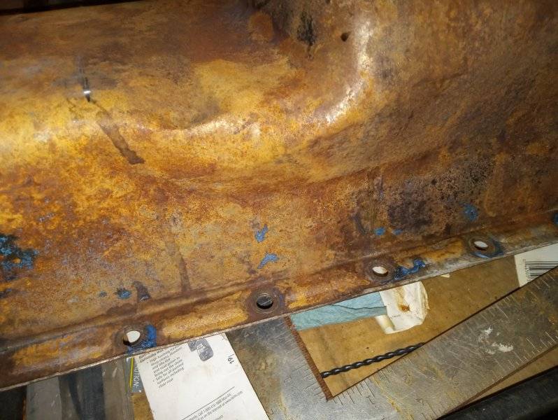

I used the screw jack from the wife's Jeep. It fit perfectly inside the pan.
Next I fired up the smoke wrench and heated the 1" crease in the left side of the pan.
Then I used one of my cordless drivers and a 3/8" drive flat head screwdriver bit to crank on the jack.
Worked great! I got about 80% of that crease out of the side of the pan. Still have about 3" that I couldn't get to...might leave it as is... maybe not.
You can see the deformed side of the pan in the photo with the jack in place.
Tomorrow I will have some help so I will try to straighten the bottom of the sump using my torch and the weight of my Coronet to push out as much as I can. Two person job.
I WILL need to straighten the left side gasket surfaces as it deformed a bit after I got the crease mostly removed.

Well I may have to toss this pan in the trash...
After giving it a close inspection I think the left pan rail has been eaten away by rust... Seems kinda thin.

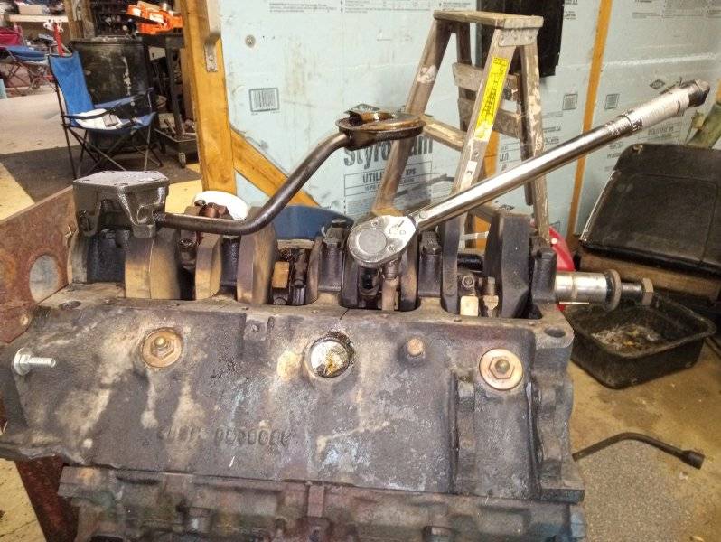

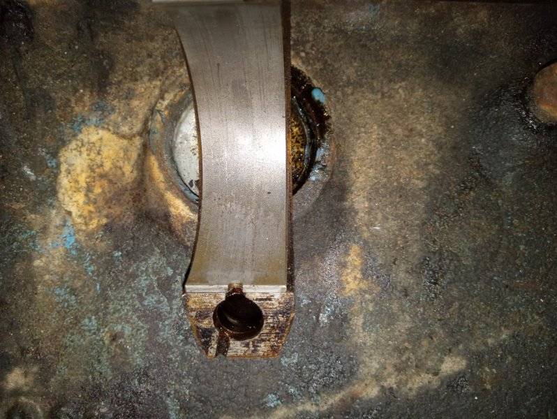

I also pulled one rod cap to look at the bearings. The bearing is dated 8/72 and is .010 under. Engine is a '73. Factory bearing. Looks very good. I will pull a main cap tomorrow.
Has a factory M72 oil pump.

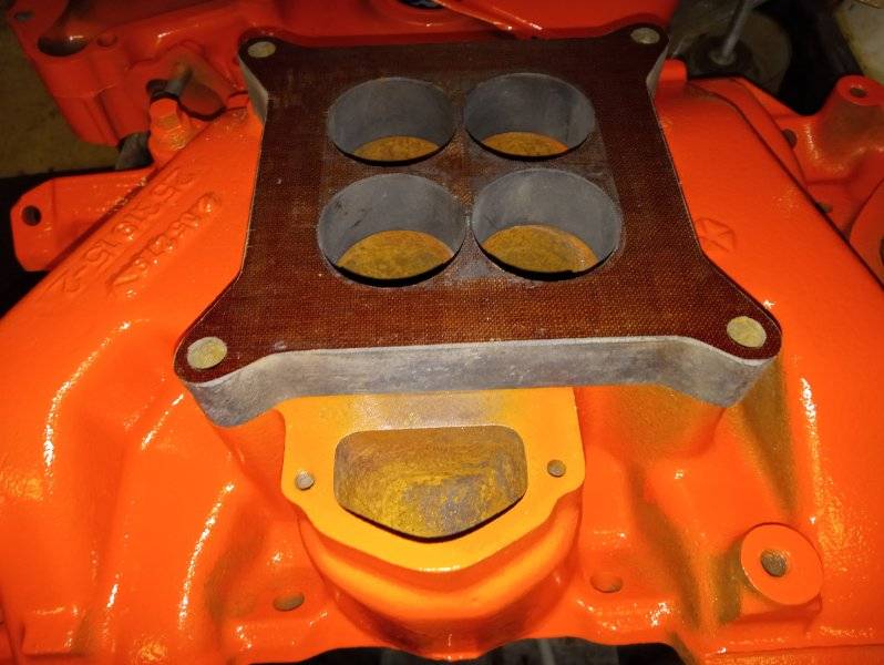

This afternoon I'm going to paint the block. I'm a big fan of Bill Hirsch or POR 15 engine paint but this is getting orange Rust-Oleum because I have a can in stock.
The 340 intake is already in color. I'm using a 1" 4 hole carb spacer I had on the shelf. The 1405 Edelbrick should be ready to go...bought it used for $50...fingers crossed.

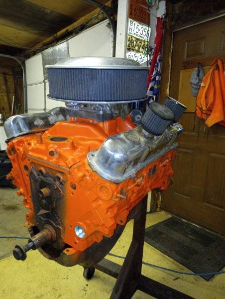

Made a bit of progress today.
Finished the paint, started installing the frost plugs, got the intake installed and mocked up the whole deal using my old race valve covers and 1" carb spacer.

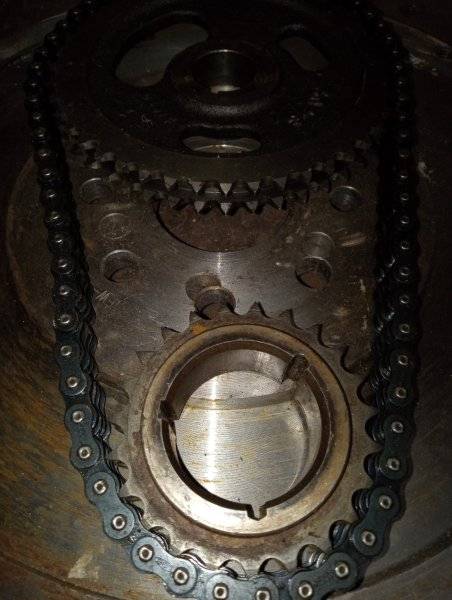

I tried to reuse the timing set I have in stock but I think the chain is shorter than stock.
The 388 I had was line bored and used a shorter chain. I think this is an SA brand timing set. Going to try to find a stock length roller chain and keep the sprockets I have.

I had planned on using a double roller timing set that I had for my old race motor but it's too short for this 318 since it fit a block that was line bored.
And I wanted to advance the cam 4* to make up for the stock retarded timing set I also have on the shelf. The solution is to file a new slot for the crank key in the 4* advanced position copying the one I WAS going to use.
So I will do a little layout work and use a Dremel and a file to duplicate that new key slot.
