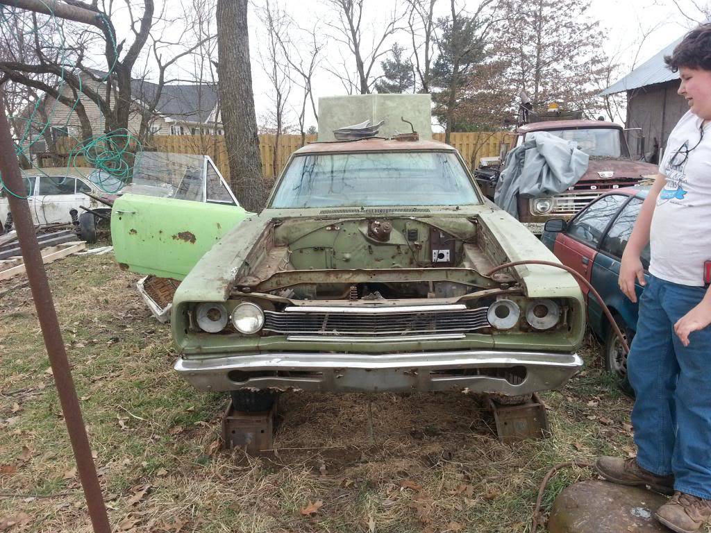

That's what i was thinking, late 69. I got some pics of it, but they are on my camera at home. But i do have some of the car from my phone, I hope they aren't too bad.
I started a gallery with pics of my car, I'll get more next time I'm there, anything specific I should take a pic of?
everything! you know how these pic whores are.....:toothy10:
ooooo a jag back by the fence and trees ooo and a hose sculpture ,thanks for posting your photos :headbang:
Haha, so I'm not good with cameras. Good eye, the jag is my dads, 79 xj12 i think. Lol Its not a hose sculpture, its a clothes line, it got in my way when i was moving my cars so i took it down, kinda. Look through my gallery and see how many cars and trucks you can identify. More pics to come.
