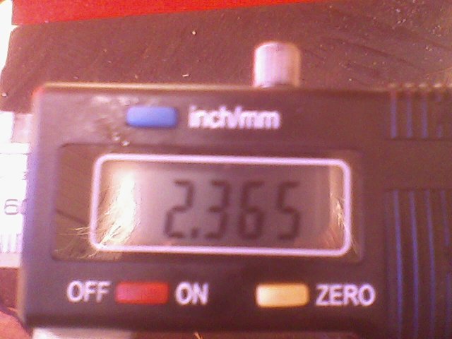

what is the ideal clearances on the main and rod journals? i checked it from the bottom of the main cap and came up with the .003-.004 , but where the bearings mate together , say , 1/4 inch in from each side, it doesnt look like they are touching the crank.
this makes it 10 under correct?

a little loose for my taste. it won't break or anything like that but will effect oil pressure some. i've always been a little paranoid of anything with over .003 on the mains. i don't like leakers and i've always felt that rear main seal just won't absorb a lot of wobble, but some folks don't have problems with loose mains. try to find out some information to see if a cast vs forged crank use a little different clearance recommendations. i thought they did, but i've slept a whole bunch since then. i hope your using a dial bore gauge to measure the bearing i.d.'s.
I hope you're good with the calipers....they are usually not as accurate as a mic is and I don't care for anything over .003
yah , Cranky im good with them things. ive measured them 20 times and getting the same numbers. i just looked at my old bearing containers and it looks like i ordered the wrong sets. the rods and mains are both 10 under and i ordered standard bearings. i never thought to check them before i put them in. i can be a dumbass sometimes. back to the drawing board lol. live and learn.

my 2 cents,calipers aren't accurate enough. dial bore gauge and outside mics. another thing, if your using arp studs they'll muddy the works up.

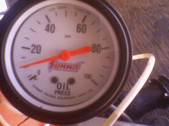

i would have never taken it back apart if the pressure hadnt been so low. it was ok (like 50) at start up when i broke it in. after about 15-20 minutes it was so low after the oil got hot that i chose to shut it down because something just wasnt right. it never made any noise and never got hot. i thought maybe the oil pump was just iffy , so i took the relief spring out and replaced it with a high pressure spring. i replaced 2 quarts of the 30 wt with 20/50, fired it up , pressure was better , about 60-65 , but then after another 15- 20 minutes it came back down again to a point i wasnt comfortable with. it was right at 10-11 lbs at about 8-900 rpm.

definitely the beauty of a run stand, i can work all the bugs out before it goes in the car

I'm lost. Are you saying you assembled it with STD bearings in a .010 under crank? In that case, yeah it would make a big difference in oil pressure like I described above. It would be more noticable with a stock pump.....

yep. i didnt double check what i had ordered before i put it together. dumbass move on my part. im glad i shut it off and took it apart again to check it. its all good , i just need to order the right bearings. cost me some money , but it will never happen again lol
Here's food for thought. You put STD bearings on a .010 under crank. Stock tight bearing clearance is like .0015 give or take. That's a thousandth and a half. You had bearings in it that were .010 too BIG in diameter, PLUS any "recommended" clearance. LOL
