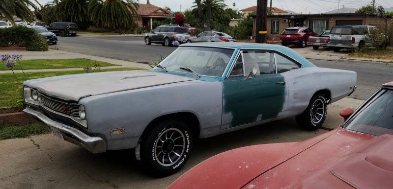

I'm considering some wheels and the title says it all so I will ask you guys if I'll run into fitment issues.
First the car, 1969 Coronet with manual drum brakes and manual steering with a stock 318. Also stock suspension and height.
Those specifics won't be changed anytime soon. Let's see if I can paste a table with the info:
Summit says it won't fit, but it seems anything that isn't a 14 inch rim won't according to them. Do you think I will run into fitment issues?
Thanks!
You'll be much happier with the look and feel of 60's series tires with more stagger to match the wheel width stagger. Something like 245/60/15 front and 275/60/15 rear.

Five inches of backspace on the rears MAY be a bit too much, BUT.... I LIKE too much backspace compared to not enough. Spacers can be used to put the tire exactly where you want it.
You can probably go to a 275, certainly a 255 on the rear.
Just pick 60 series or 70 series, depending on how tall you wanna be.
Personally... 70s don't drive as well as 60s, but I like the way they fill an opening.
Edit: the 15x7s on the front should fall on the car. Good fit.

I went with a 225/60/70 tire on the front of my 67 coronet with manual steering, and I don't have any problems with steering it? And it handles great. And I run a 275/60/15 drag radial in the rear
That is the tire sizes I run on my 65 Coronet 500
Mission accomplished.
Just putting a cap on this thread for future searches. I ended up with 246/60 15s on the front and the big unexpected test was creeping behind the businesses at the strip mall where I fueled up and a delivery truck blocked the way so I had to do a 3 point turn and it was fine. A lot of revolutions of the wheel but low effort.
