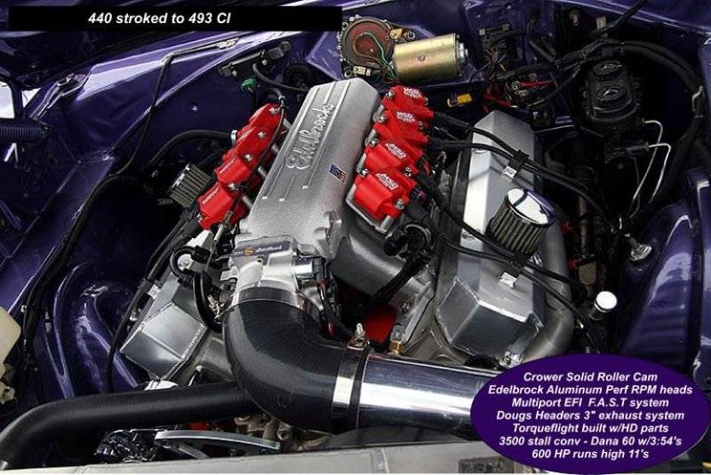

Im 70 and need some advice fro you experienced race guys. My 70 Charger 500 has a 493/440 efi w/3500 stall and worked 727 trans. 3:54 gears. 275/65 BFG rear tires. It has 580HP and has run high 11's by previous owner. While I dont intend to race it, I would love to impress the young guys in my rural town by lifting the ft when I hammer it. Currently it just roasts the tires. It has traction bars. Im assuming big slicks/tubbed and gear change? Cant wait to hear your constructive advice. Thanks

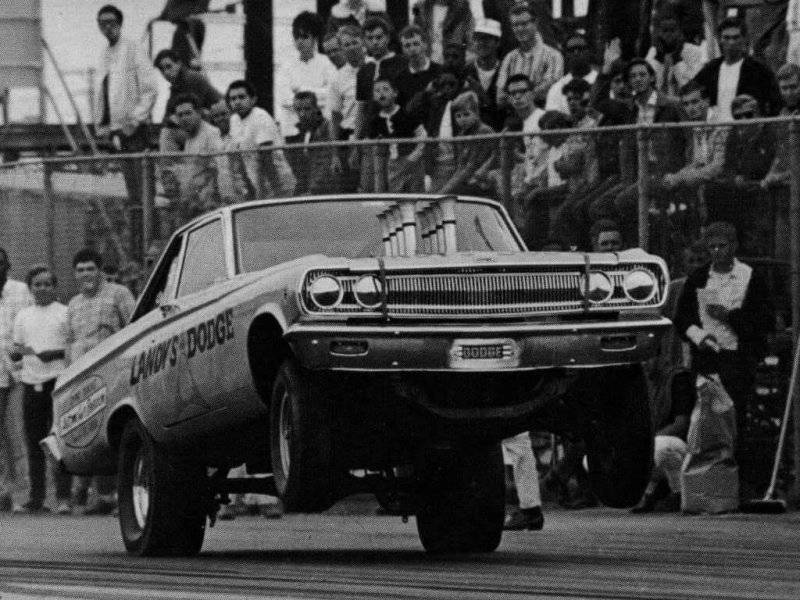

Nice car, Great answers. If all else fails, you could do what Dick Landy did and put 300 pounds of sand bags in your trunk.
It always seemed to work for him!! :D
You have to watch those landings though!! :p
Don't forget, wheelies can become habit forming!
Just ask the fellow below. Good Luck, you wild and crazy guy! :)
