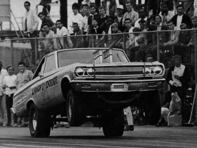

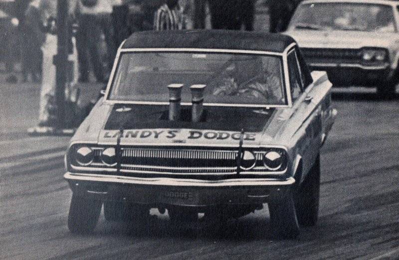

Nice car, Great answers. If all else fails, you could do what Dick Landy did and put 300 pounds of sand bags in your trunk.
It always seemed to work for him!! :D
You have to watch those landings though!! :p

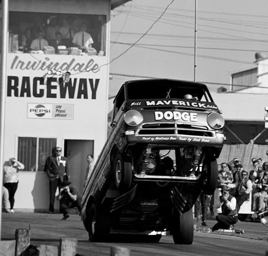

Just ask the fellow below. Good Luck, you wild and crazy guy! :)
I attended the old Irwindale a bunch, might have been there that day.
Some day I'll tell the story of the rocket car I saw at Irwindale,.....and the food stand.

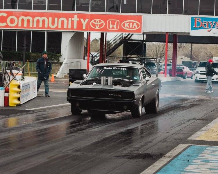

DVW & 33IMP are correct, my Charger will spin on the street, at the track it will stick, these Chargers are very heavy takes a lot of power & the correct suspension AND a very good surface to pull the front end. my Street car @ the track
