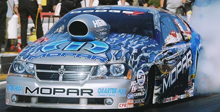

I want to try a different hood scoop......
SUPERSTOCKRACER

On my black dodge. Which style is the fastest? I think mine is acting like a parachute.
This one

It would be for these heads up races only Kevin, I know, I don't like them either but I know i'm giving up a lot of mph & ET.
Would a six pak scoop clear? Looks like your carb is almost aginst the top of the scoop?
Your car looks Super Cool with the current scoop, but i would say one of the newer Aero scoops would be more efficient.
I like the aero scoops. But I see a lot of fast cars going to the cowl hood. There's got to be a reason.
I never really got the cowl hood. is it a venturi-type effect?
I would think facing the wind would be more efficient.
I turn my head away when I see a Mopar with a cowl hood, I guess it's a Chevy thing.
Your at the point where function has to rule over form.
The aero scoop you chose suits the car a little better because it has a flat oval opening that is more similar to the grille than others.
If we're actually talking about going faster, not what LOOKS good, take a page from the Mopar engineers: that is, use a scoop that you can seal to the carburetor airhorns. According to the direct connection manual, if the scoop isn't sealed to the carbs, it's not helping, and possibly hurting your ETs, by not having "smooth" air across the airhorns.
I ran a C/Gas Corvette years ago with an all out 331" small block and a tunnel ram with 660 Holleys. Just by sealing the carbs to the scoop I picked up 4 tenths. Nothing to sneeze at...
I don't have enough room above to seal the carbs.
If and when I put this new scoop on, it has to be the fastest one. I have the extra hood to use, now I just need to get the best one for my application.
