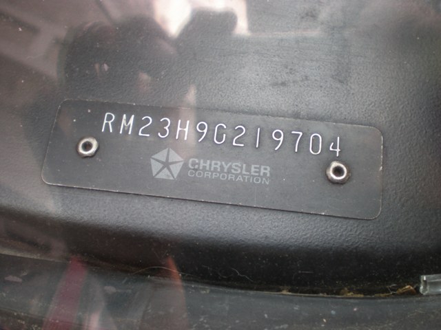

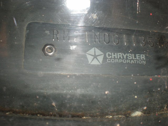

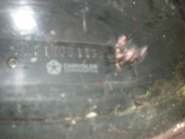

yup , sometimes it so bad my charger title has a C in it
Often the "G" for St. Louis plant, doesn't have a full 'tail' so it looks like a "C". As there were no B bodies built at the Jefferson plant, this has to be a "G".
I found a Charger 2 weeks ago with 2 "G's" looking like they were a "C".... had me scratching my head for a minute when I decoded it lol
