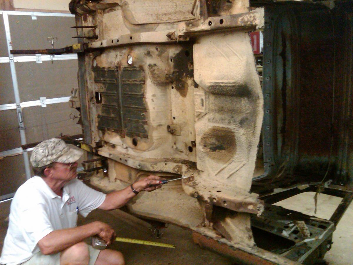

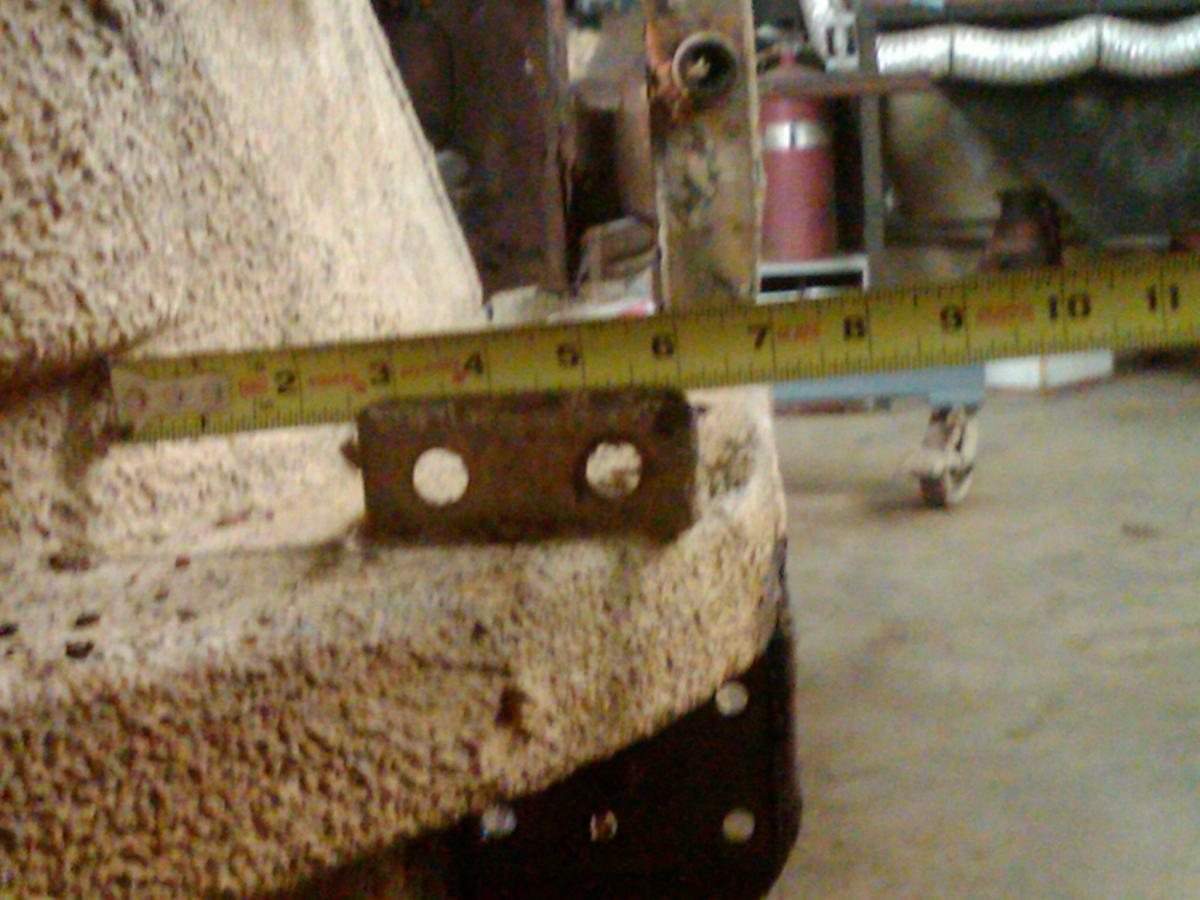

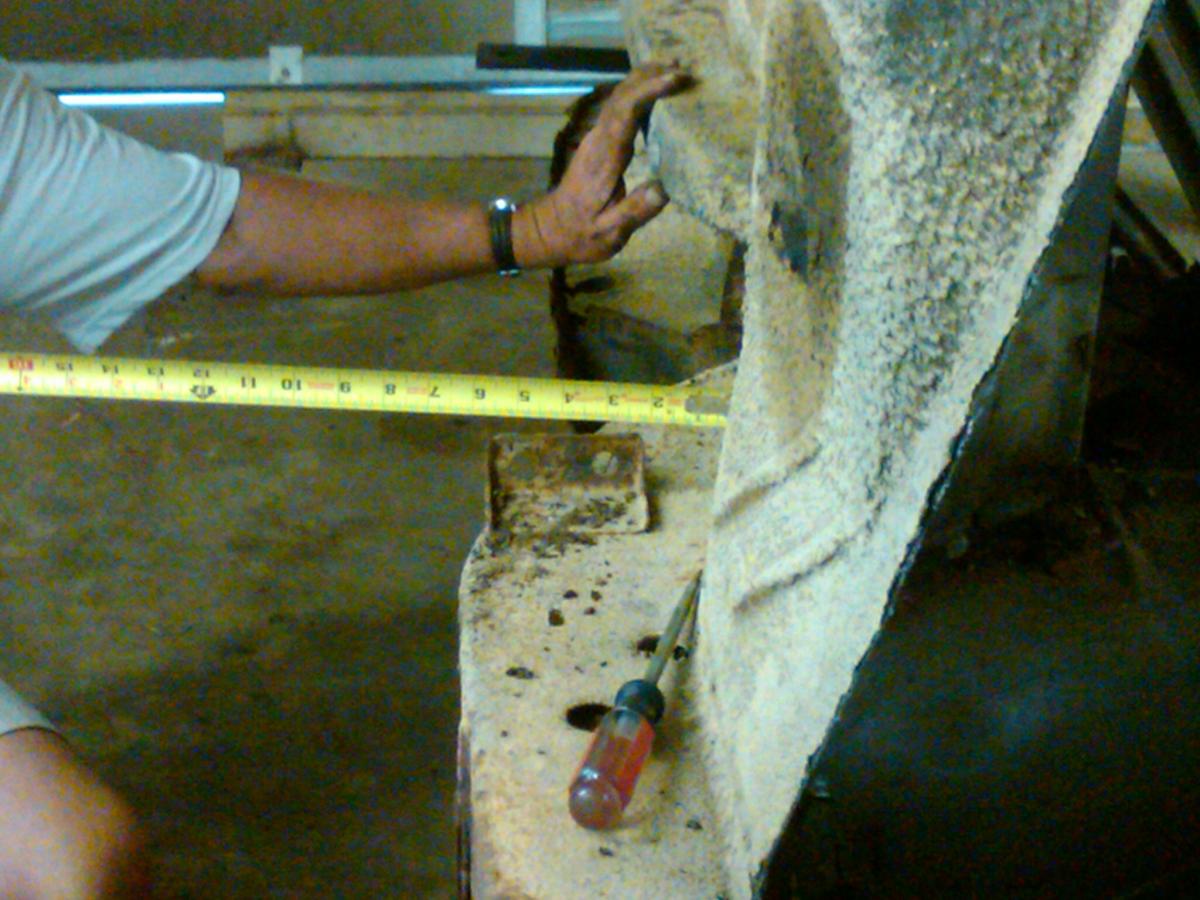

These brackets are on the inside of the frame of a 64 post car about 14"'s in front of the rear axle on both sides of the car frame. Two holes in each bracket but we didn't take anything off of em. Looks like it may be a bracket for a sway bar. Not sure but i know there's a guru here that knows. Clue me in please. Here's the pics. Thanks guys.

Those are the emergency brake cable supports. On the axle side is a flexible cable housing and on the other side is the bare cable. If that doesn't make sense I'll post a picture tomorrow.
those are e/brake cable brackets,the cable mounts with a u shaped clip.

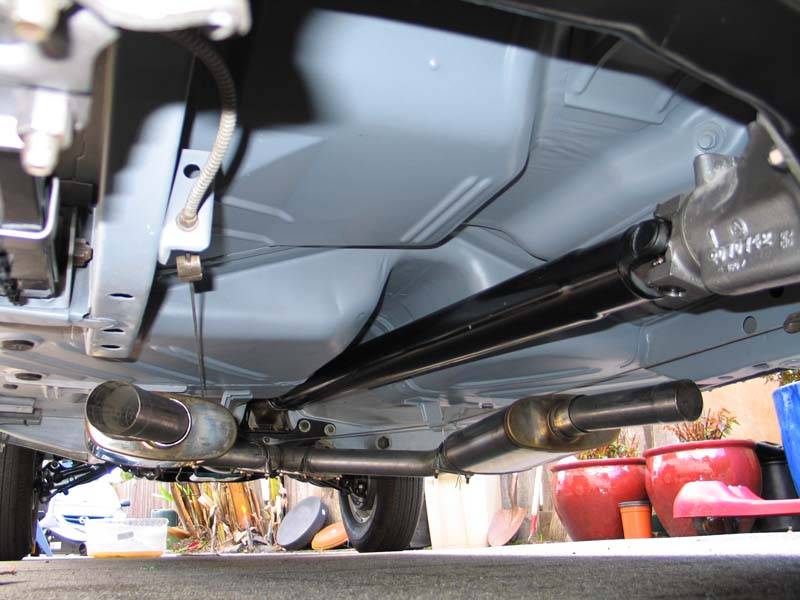

Hi SB I'll have t get you those on Tuesday when im back at the computer. There are only two other brackets that route the bare cable up by the exhaust. You can kinda see it in the pic above but maybe someone else can post a shot.
