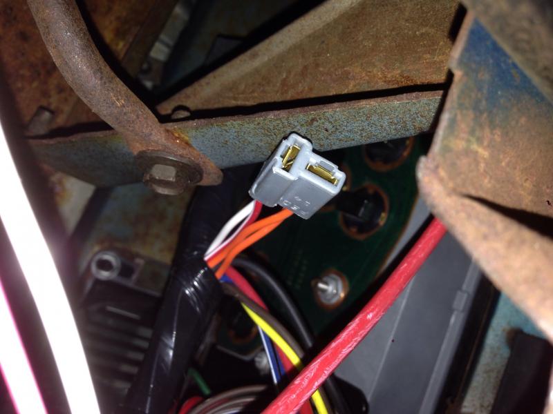

Identify this connector under dash
68 Sport Satellite
5:42 AM
Feb 10, 2010
2,573
2,056
San Jose, CA
68 Plymouth sport satellite with new M&H harness. What is this connector? I see no mating piece. image.jpg
Thanks guys. Which is it? If it's blinkers that would explain my lack of blinkers!
If it's blinkers, why can't I see or access a mating connection? Do I need to take the steering column apart? I see nothing under dash.
Yeah I'd say radio also I believe the blinker wires are yellow and/ or pink
It is the radio. Orange is dash lights, red is the ignition feed, white is the back-up lamp feed. Same connector as the hazzard and turn signal flashers, different circuits.
