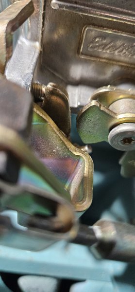

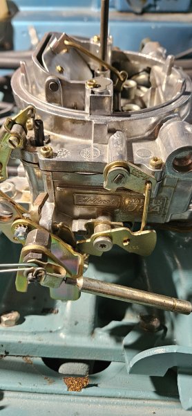

Ok here's what I have nothing is touching that cam when it's high idling after I goose the throttle and the idle drops still nothing is touching anything. If I touch this linkage on the choke side idle drops. Not the best video but it's what I'm talking about it won't let me load the video sorry
As Geoff 2 started to post, could be a worn and sticking/dragging primary throttle shaft. From the plated parts of the carb linkage though, it doesn’t look like a well worn carb. Could also be as simple as needing a stronger return spring.
Another thing to check is to make sure your secondaries aren't hanging up and fully close at idle.
Good point. I’ve seen that heavy gage bent link rod (and associated stop) on the choke side of the carb that links the primary and secondary throttle shafts, get bent out of adjustment somehow and then it can’t pull the secondaries closed.
I think you need to check all adjustments over again, from the beginning. AND, free movement of all pivot places.
First off I appreciate all the responses. I love this forum. Almost everything I need to know I've found by reading other posts. Back to mine. It's been a beautiful weekend had the car out everyday plus a show on Saturday. I pulled the carb off to look at the primaries and they are closed as they should be. They're not sticking open. I adjusted my slow idle screw a bit downward and it didn't fix the problem but the high speed idle is only about 1100 now not 1600. And the low idle didn't change much. It's about the same. I'm gonna adjust the high idle screw down a bit and see if that does anything. None of this was a problem till I started messing with stuff. Lol. So I figured all along it was self caused but I just didn't know where to start with fixing it. I'm pretty sure it's the idle screws being not very knowledgeable about this stuff. Just makes it harder.

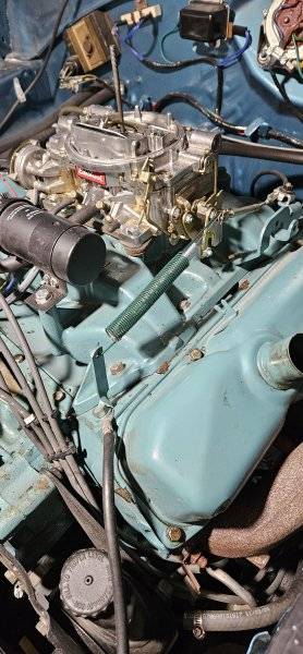

This is how it looks cold before I start or hit the gas and here's the return spring setup
Yeah the choke shouldn’t be that far closed unless you pressed down on the pedal enough to allow the cam to slide by the adjustment screw. Once you press part way down on the pedal on a cold engine then the choke should snap mostly closed. But you said you had not touched the throttle which implies the choke plate is sitting mostly the way it was when you last shut off the engine hot - partly closed.
