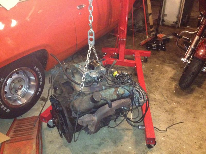

Well I've found myself at a cross roads. The original 440 is out of my 72 GTX and although extremely ugly and a couple of minor oil the leaks the motor ran perfect and didn't smoke at all. Based on the odometer the car has either 75K or 175K and I'm thinking 75K. I've only owed it for about 8 weeks and my best guess it sat somewhere for several years. I know the last owner kept it in a garage and only put a few 100 miles since 2006.
I have a 1978 freshly machined low compression short block and a set of freshly machined 906 casting stock heads. Without additional machining this will produce about 300 HP but I have to come up with all the other parts.
My other option is simply clean and paint the original motor and re-install it without doing any major work.
What else could I do to the stock original motor to freshen it up without spending a fortune.

If I yank one out, I usually pull the heads and freshen them up. Even at 75k miles a valve job is a good idea, beside you get to inspect the cylinder walls as well.
If the 440 runs good and doesn't smoke, replace the leaky gaskets, clean and paint it. Or use the cam and intake or whatever parts you need for the motor that has been machined.
Bearings, rings,light hone, gasket set, valve stem seals... check specification on springs, look for wear on the seats.....new timing set and a fuel pump oil pump..... you don't want to wait for major problems to freshen it up and almost always you will find something you caught just in time..... like the rear main seal.

If you do nothing else, replace the timing chain. With that sort of mileage, it probably needs it. For me, I would tear the engine down. Unless you plan to have a 'survivor' car and you may have gone too far for that now. If you are a paint daub and inspector stamp guy, just take lots of photos and document everything.
Thanks guys, I'm not going to the survivor level with stamps and paint daubs but I would like to keep the original motor in the car and maintain a stock as possible look but I'm concerned that the original OEM intake and exhaust will limit the performance possibilities. I think I'd also have to raise the compression by modifying the block and heads which I'm not sure if it's worth the money and modifying the original block and heads.
Intake yes Will limit... exaust no until you get to 600 up.... the heads with a mild port polish some bronze guides 3angle job a stainless valves New 750 cfm carb.... 2200 stall converter rv shift kit on a fresh trans wakes it up for cheap. Seals hoses gaskets all around. A stock motor tuned up will rock!!!!! a big block with a few dropped valves on 7 cylinders will still have more balls than a good running stock small block...

The Performer RPM intake would be a nice addition to your combo. The 440 Performer is an older style dual plane, and doesn't work as well as the newer stuff. The Perf RPM sits pretty high, and I'm sure it won't fit right with spacers on there. With out spacers it would prob fit with a drop down air filter.

What really makes the difference on how a motor is gonna run...is how well it's put together. Somebody with 'deep pockets' can shove all kinds of high-dollar parts and pieces into a motor, but do a lousy assembly, and get a big turd.
Even with stock parts, but assembled as it should be, it will definately get the groceries. Have fun with it!
Nice car by the way, I have the 72 Satellite Sebring plus im working on, but nothing original on mine lol. I personally like some above would clean up the motor since its out. Just your basic over haul kit for all new gaskets, bearings, and for sure a timing chain, if its a single roller swap out to a double roller longer lasting. And just line hone that way everything is fresh and you'll know you have good compression with the new rings. Its all I did when I first put a 440 into mine.
