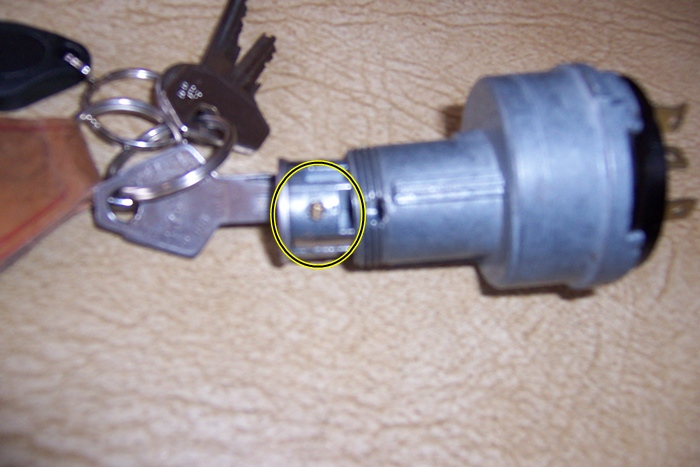

Need to remove the ignition key cylinder from the switch. Before I destroy it how does it come out?
Thanks.

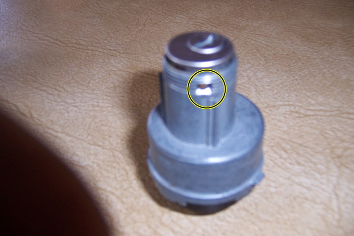

insert the key into the cylinder. Turn the key to the right as you would to start the car, press the little brass button (encircled) and pull the cylinder out with the key.
