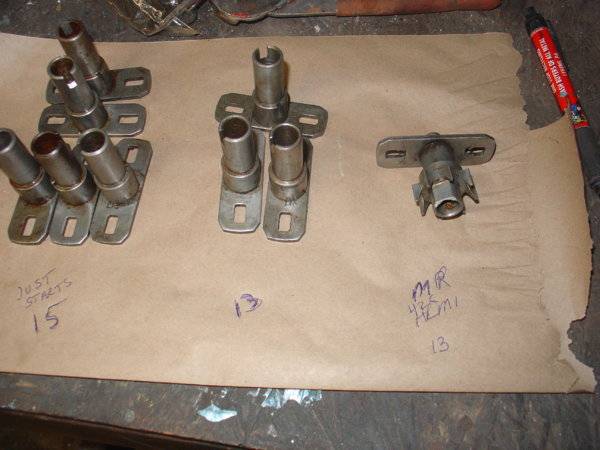

No! The stock dizzy has a limiter plate. Look at the plate and rotate it you will see a stop that prevents it from going any higher. You have to remove it or grind it off. If you don't have the limiter then you have to change springs which you can order from mancini or from Richard Eherenberg the writer for Mopar magazine.
The distributor you have is fine. I haven't looked inside a small block distributo in a while but something is limiting the mechanical advance. Springs (in almost all cases) only make the mechanical advance come in faster/slower. I guess you "could" temporarily remove the larger funky ended, bigger spring as a test to see if your total advance stays the same or not. If your total is still 27, then you have to modify the limiter plate snakeoil is talking about. If the total advance goes way up, then you could change spring (or springs). Other thing would be to advance your distributor if the engine still runs right. Total advance = Initial timing advance + mechanical advance. Snakeoils idea is probably correct, but I would play around with initial timing first (running premium gas to avoid spark knock). I normally run as much initial timing as I can and then limit the total timing (not reduce the limit) + not all engines will run their best at 36 degrees total.

you probably need an 11 degree advance plate but may have a 9, or less. all you have to do is increase the length of the slot. every .015" increase in slot length will add 2 crankshaft degrees.

Now if you are brave you could file the slots, it may even like more. It would be based on ability to crank easily but most of all detonation.
