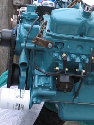

One thing too... are your motor mounts installed on the correct side of the block's mounting ears? They plates should be on the rear of the ears as seen here. Maybe something to check.

Are the heads against the firewall and the bellhousing against the floor, too?
