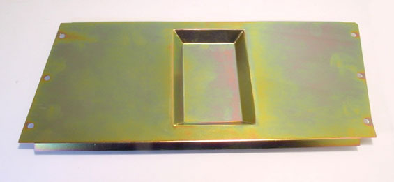

I developed an oil leak a few weeks ago on my Charger (499 cu in., .620 lift flat tappet cam, 906 heads) and it turned out the valley pan gasket had cracked. It had seen a lot of passes so I just replaced it. The new one cracked in one race (10 passes). Seems like one of the valves on my headers failed. Anyway, I ordered a another new valley pan and this time got one that's heavier and seems to be plated. The part number was MS960007 I think. I don't remember the number of the first one.
Anybody know anything about the heavier gasket?

Is that a Fel-Pro number? A block of soft/sponge rubber will absorb those crack causing harmonics. Wrap it like the factory did with the fiberglass batt. I cannot address the difference in gaskets though.

It's just the standard replacement pan. The felpro 1214 is the same with blocked exhaust ports.

If your using header evac and a valve fails, it will crack the stock type valley pans. I don't know if the metal thickness is different?
I usually use the Fel-Pro 1214/1215 without the exhaust crossover cutout.

I'll be happy if that's the problem. A friend at the track suggested that may be the trouble. I'll find out this weekend.

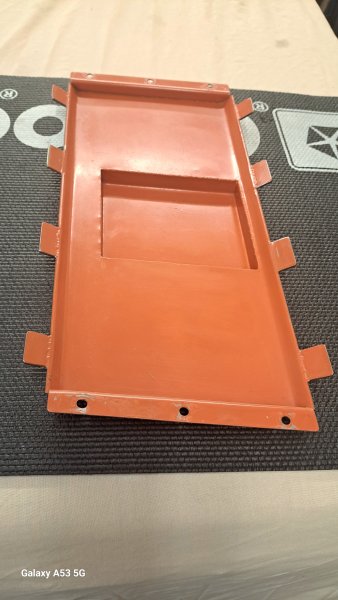

I made this quit a few years ago to eliminate the valley pan gasket with iron heads. it works.
