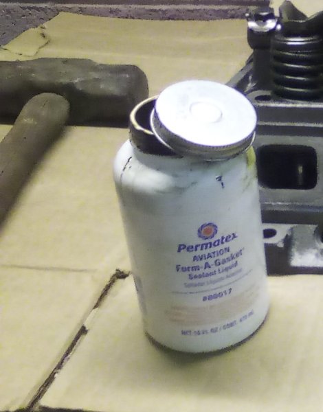

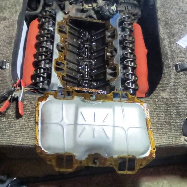

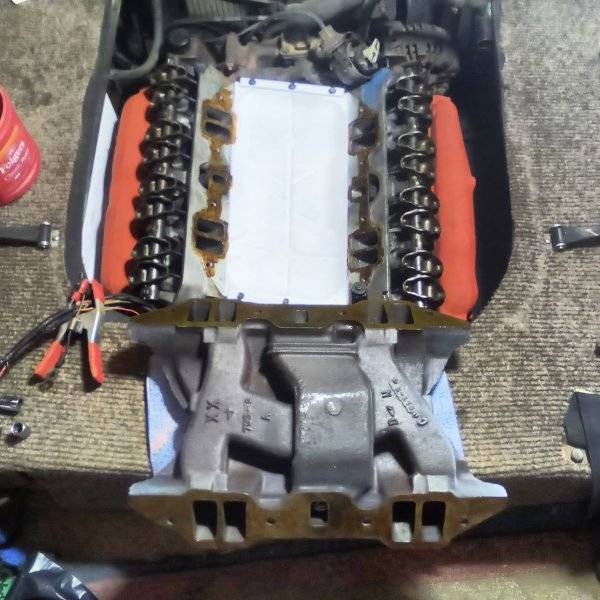

The Permatex form a gasket sealed up the valley pan and the intake manifold and the valve covers making a very very gas tight engine.
Permatex Form a Gasket.jpgIMG_20231116_122742_DRO.jpgIMG_20231116_130351_DRO.jpg
