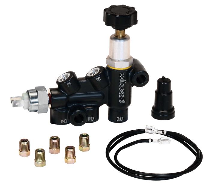

Just got off the phone with Wilwood, thanks again for the link, I hadnt even thought to contact them, they suggested eliminating the factory proportioning valve...anyone else used thsi approach??
I would agree with that. The factory proportioning valve is non adjustable and utilizes a certain sized orifice in the block to supply a controlled pressure at load to the rear brakes. It was engineered to work with your factory brakes, not Wilwoods. I'm guessing your car had front factory disc and rear drum? If so, it's really going to be off now you have disc in the back. If your car came with drum/drum, that original block under your hood isn't even a proportioning valve, it's a distribution block that just routes fluid to each wheel from a centralized junction. Being you have an aftermarket kit all the way around, you would need a variable control (ie adjustable proportioning valve) to compensate the difference in braking pressure needed between front and rear (about 60% Bias to the front). Wilwood makes a combination proportioning/distribution block that would work, or if you had a drum/drum car with that factory distribution block you could plumb in a variable control proportioning valve in your line to the rear brakes. I would also ask Wilwood if you need an in-line residual valve for the rears with your current set up.
Wilwood Combination prop valve
Wilwood prop valve
