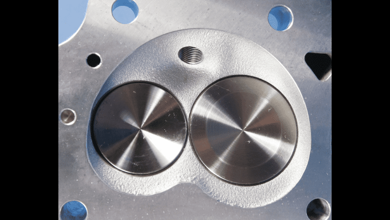

Something I found odd.....I’m not sure why new CNC’d heads would need the ports bead blasted.
The intake port openings don’t look as big as the 345’s I’ve had here....... wouldn’t surprise me if they were really 325’s.
Then there’s this gem in the pics of the build:
(That’s not a pic of an Indy head)
