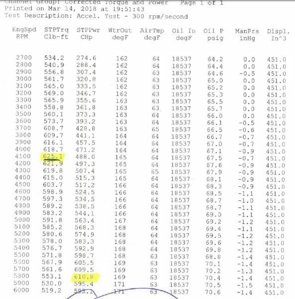

I totally agree, I did a 451 and put in a 1 7/8 heade with TFS 240 and cleaned the ribs out to reduce turbulance and it really had turbulance. got very nice street #'s and the can runs awesome. more than enough hp and TQ 613hp and 625tq and the nice part it's with a custom flat tappet and rpm intake. I read alot of input Andyf has provided and that helped me out. Look at the low RPM #s where it really matters on a street car. Good Luck Likew Andyf says go with TFS and 1 3/4 or 1 7/8 header
