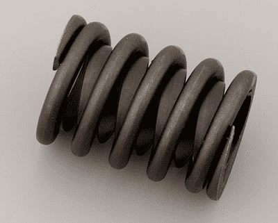

Are the dual springs too much for this cam on break-in?

Generally it's always advised to remove the inner spring on break in.
My question would be whether the dual springs are necessary on a street cruiser
Thought I was bad about 'life getting in the way' of doing stuff lol. I don't have the cam numbers handy....but even with a 509, with today's oils, it's best to break in with say a stock single spring imo.
