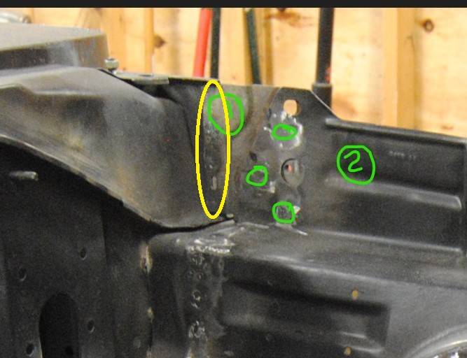

Hi All,
I'm having to redo some work on my 68 charger and don't have good quality photo showing the quantity and locations of the welds from the (1) cowl bracket to the (2) inner fender as shown in the photo below is the best I have (green circles is where I beleive the welds are at - these might be weld up from the screws). Can someone please confirm the locations and quantity of the welds? A photo would be great. Thanks in advance!

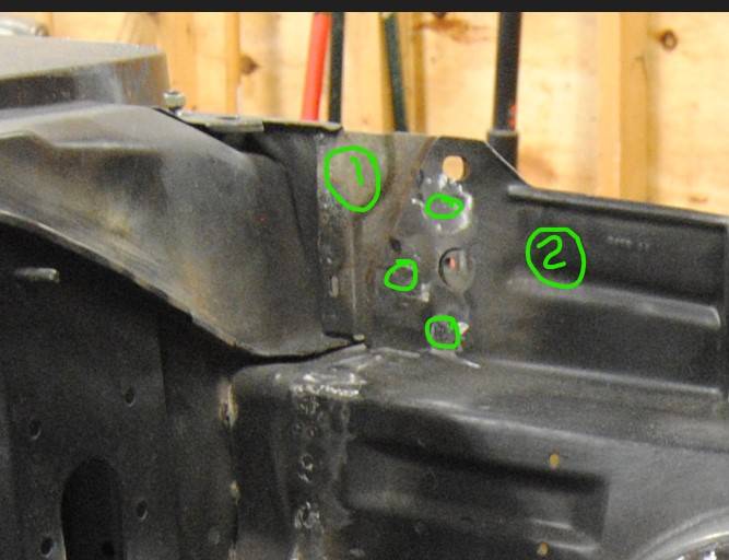

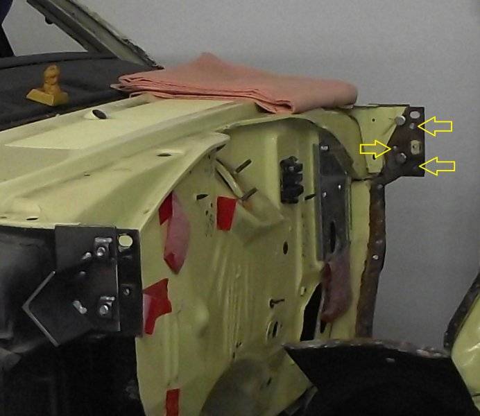

The welds in the yellow area are only to secure the two pieces of the bracket together. The other welds you circled in green are the inner fender to bracket welds. See the yellow arrows in the second photo. Are you replacing the brackets or just the inner fenders?

Perfect. Thanks! Replacing just the brackets. The 2 brackets are welded together already.
I hope you bought the AMD ones, the other ones are crap and will take a day of massaging to fit decent !!
And note that the ENTIRE front end metal alignment is dependent on those brackets being in the right place !!!
