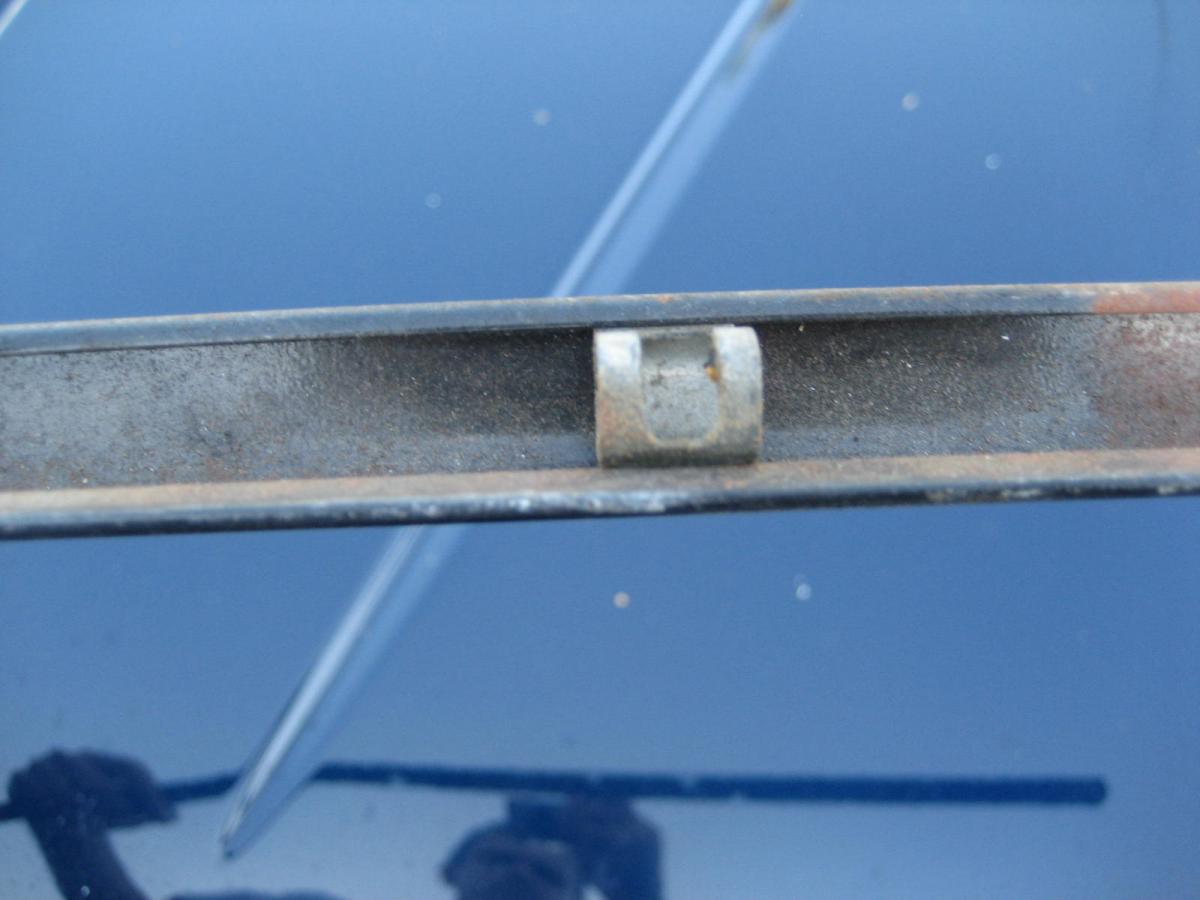

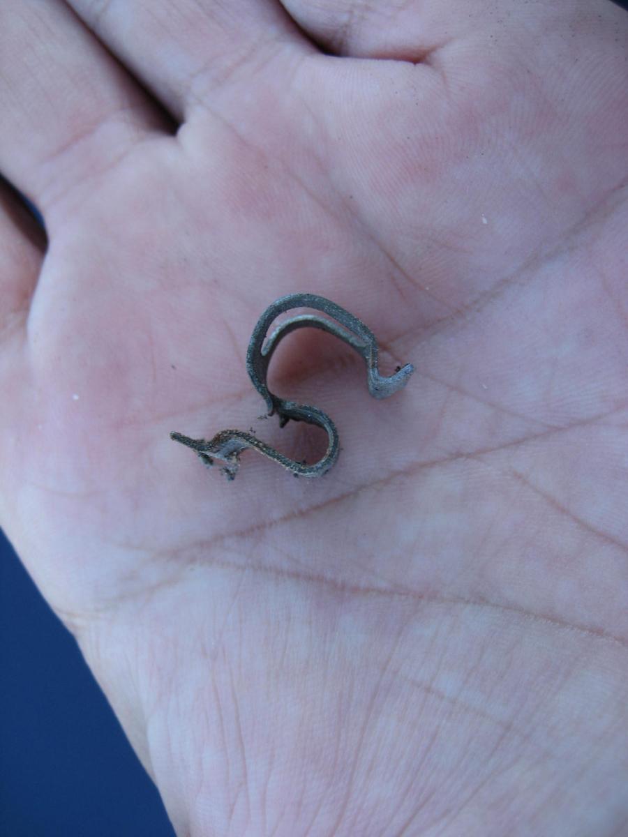

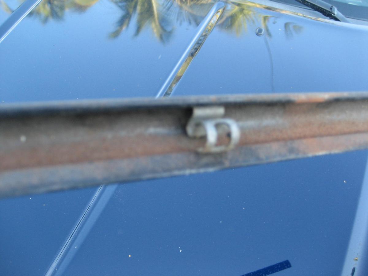

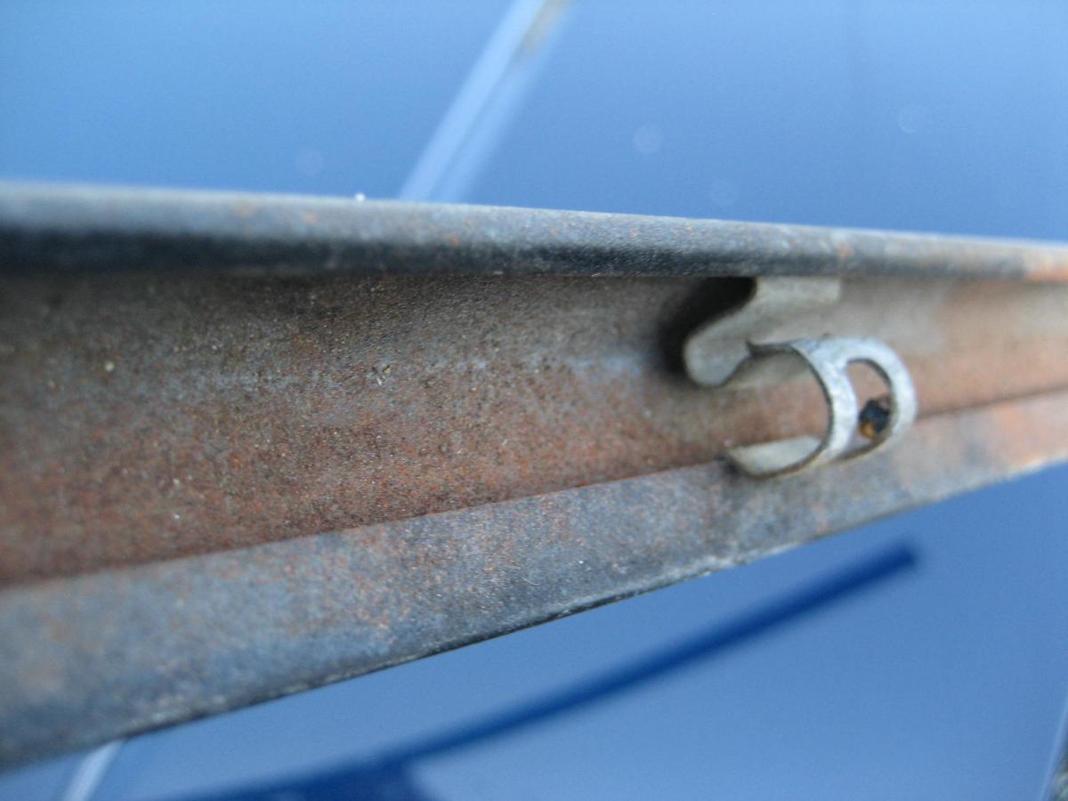

Hello. I have a 1968 gtx. Does anybody know how the painted rails that cover the inside headliner along the glass fasten. I have clips but they are old and i cant remember if they screw to the inside of the car because i cant find any holes inside were they screwed and i wondered who sells them. Also how does the inside plastic trim fasten around the back window. Thanks.
Painted trim has 6 clips per side. I don't know, but don't think they are, if these are available new, if you need some PM me I know I have them.
Rear window molding pushes on to the headliner barbs around the sides and top, the bottom goes on to the package tray.
thanks. there is one hole in this trim piece in the front but i guess i am not sure what these clips look like. i thought i had them but its hard to tell without seeing them.
Here are the pic's

any body know who has these clips
Most of mine are missing any body get these latey? thanks CD
