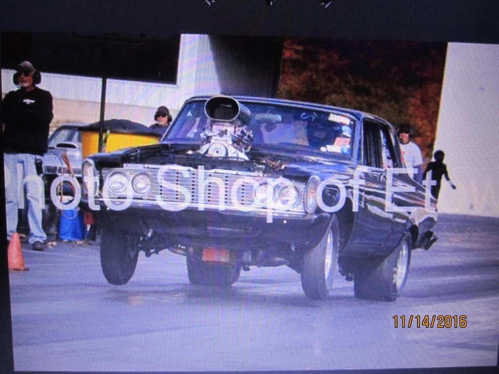

Installed Cal-Trac style bars..
Well I'll have to be honest. Never been questioned about u bolt diameter. Length yes especially if they do not pertrude past the nut so far same as lug nuts and wheel studs. So I called and asked and got the same response from smith racecraft never heard of it being an issue. ???

So your car picked up with additional preload?? Mine are set like Dodge 330,and have Viking DA's and have not tried to tune yet.Car leaves stright,I've been chasing AFRs and never played with the suspension,,,,,,,,,,,,yet. Went to a track rental a few weeks ago,taking timing out 2* atta time........
My car just flat wouldn't work without preload. I actually went to the track and just did 60fts till I got it close. It really started to work once I went to tubular uppers and strut rods. Again my car is extremely heavy up front being a mega block, iron heads, cross ram, 10 qt pan, and 26" radiator. I'm sure if I ever get enough weight off the front I'll have to change the setup.
LMOL!!! I also have the mega block with STOCK iron 68 or 69 heads,,but throw a blower and a pair of SV1's and now I have 1000lbs of ballast over the front tires:realcrazy::realcrazy::realcrazy::realcrazy:

My buddy that put CalTracs in had many problems getting them set up. However once he got them setup he was really happy.
Then dialing in the shocks & cal s are like tuning a carb or two.
