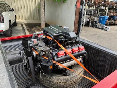

Last year, I bought this replacement engine for my high mile truck:
Why? Well....
I had the long block checked out. The heads were rebuilt but the bottom end was fine as-is so I'm leaving it alone. I pulled the lifters and set them aside.....then one rack of 4 fell out of a box and came out of the cage they were in.

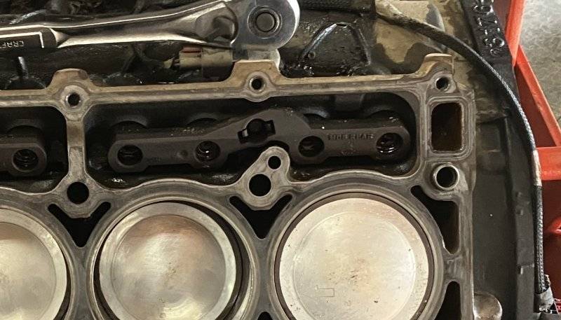

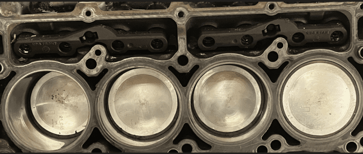

I'm curious though....If the cam looks okay and the lifters are fine, am I really okay to put them all back in regardless of what hole they are in? I know the MDS requires the lifters to be in proper sequence as evident by this picture:
Cam failures usually mean a complete teardown of an engine to get all the crap out of it all. I need to know I'll be safe.
Is it fair to think that as long as the MDS lifters are in the MDS location that there won't be a problem if the lifters now ride on different cam lobes?

Not sure where you got that gem from. If a cam gets replaced (flat or roller), the lifters get replaced too. Just because they are roller lifters doesn't mean they don't break-in to a lobe, they do. Most manufacturers will void any warranty if the lifters aren't replaced also.
Kern, I would put 4 new lifters in to be safe, unless you want to possibly do the job twice...
