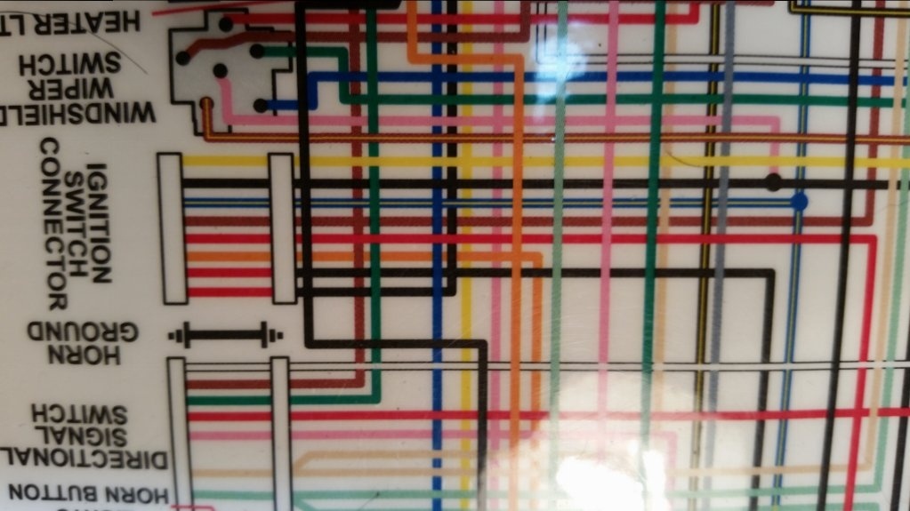

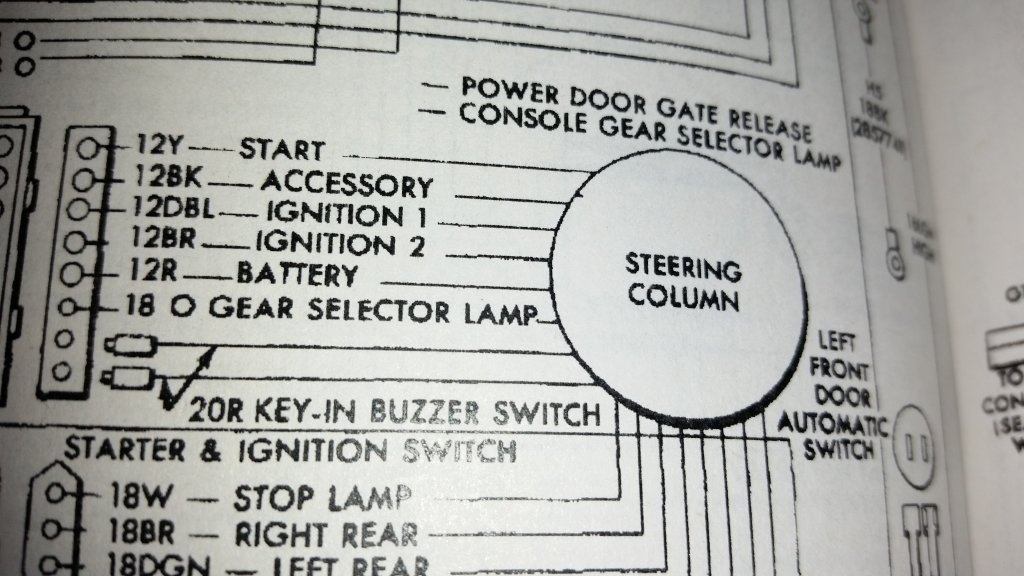

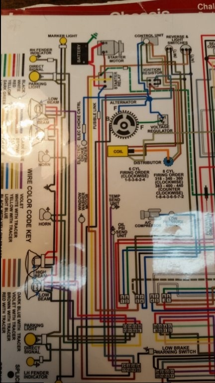

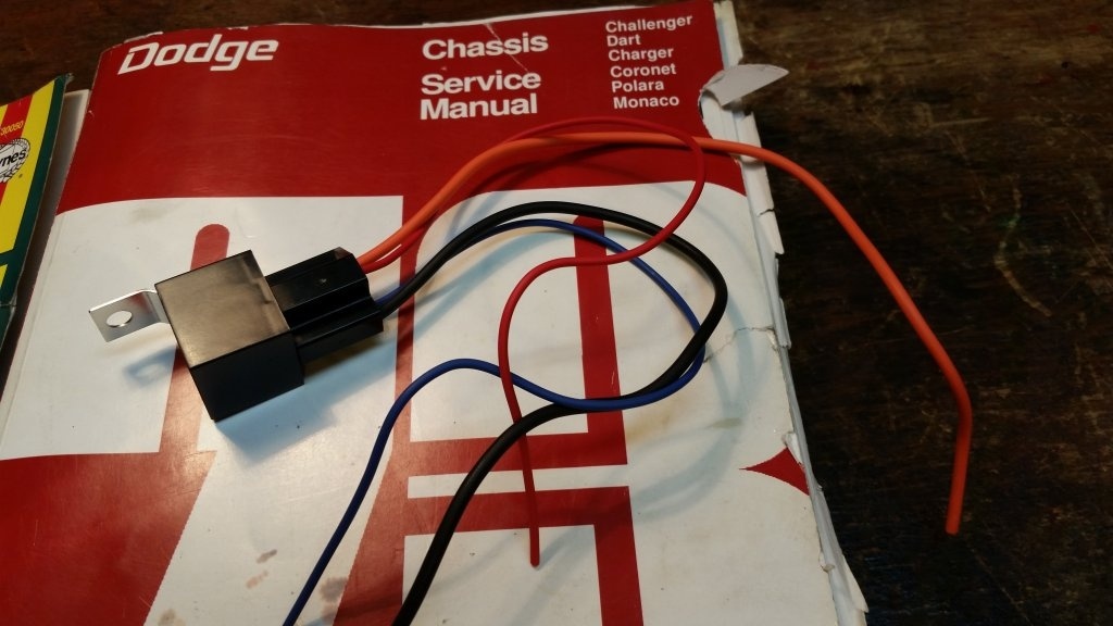

I purchased one awhile ago and redid my ignition harness connection and thought I would do this also. I'm looking for a second set of eyes to make sure I'm looking at this correctly.
Ignition black wire to black relay wire .
Yellow ignition wire to orange relay wire.
Blue relay wire to ground.
Red relay wire to negative side of switch.

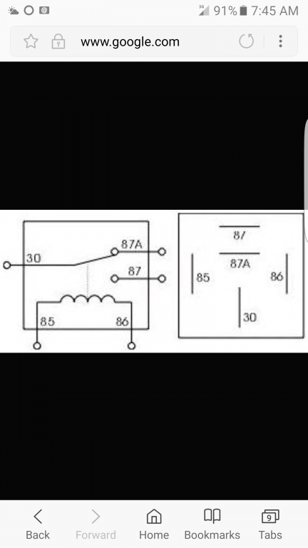

Take the time to understand the relay and what it does and you won't need a diagram. Looking at this picture 85 and 86 will be your signal to engage the relay (12V - and +), it doesn't matter if you use positive or negative to do the switching but generally it's the positive. In cases where your concealing the switch in tight spaces it's handy to use the negative because all you need is 1 wire with the other side of the switch grounded.
Terminal 30, 87A and 87 are just a switch inside the relay. Using 30 as the incoming power you just select whether you want a normally open or closed contact. The drawing illustrates the relay in it's natural state (de energized).
Now to make it work you simply connect your theft switch to 85 or 86 (1 grounded and 1 getting the signal from your switch) and interrupt your starter wire or coil wire with 30 and 87.
The nice thing about this is you can literally use just about any existing circuit as a theft switch or install your own. You could use your windshield washer switch by simply running a wire from your washer feed to one side of the relay..... car won't start unless your pushing the washer button while turning the key. In most cases people just hide a switch.

Are you referring to the dark blue wire coming from ignition switch, running through the bulk head connector on pin 23 and continuing on to the wire junction at the ignition resistor?

My relay say's on the back it's a 30/40 amp I think my switch is a 15 or 20 amp do I need to get a higher amperage switch ?
