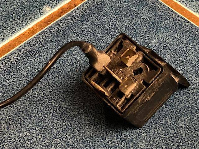

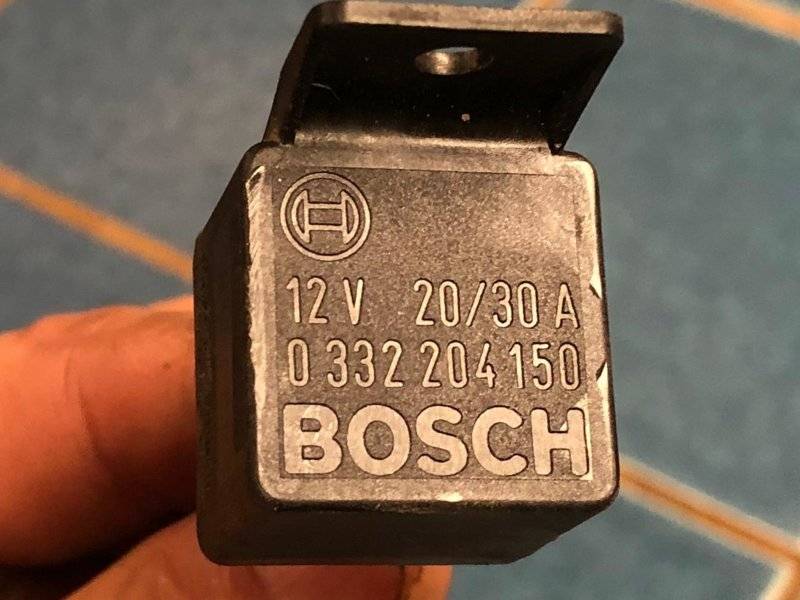

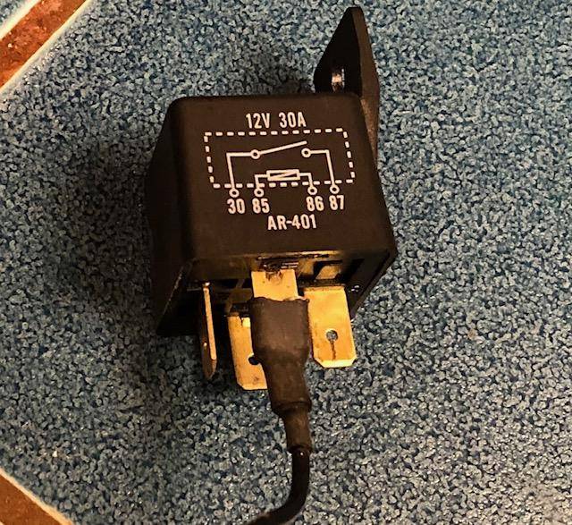

I have this Bosch relay:

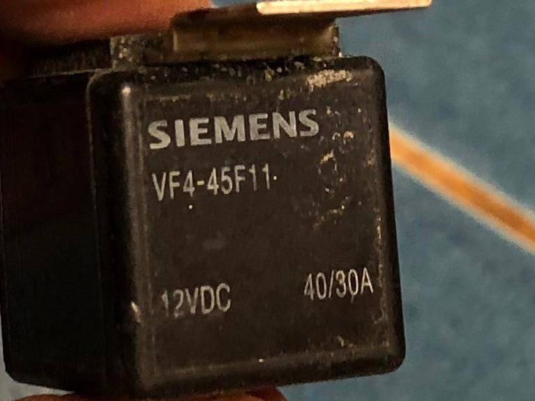

I also have this Siemens relay...

I’d use the Siemens relay to power your fuse box, it’s high quality & rated 30/40 amps..
The relays for your headlights are about 50-50 between toss/keep and really the only reason I’d keep them is as spares cause no-name Chinese relays don’t have a great track record for reliability
Thanks. I figure that the Siemens and Bosch are both quality parts. I also like the metal mounting tab on the Siemens relay.

Hey Kern just for general knowledge...think of a relay as a simple lightswitch. Except instead of needing your hand to flip it one way or the other to operate, it's activated by electricity. Using the relay in your post #144 for an example, the terminals shown as 30 and 87 are the switch to the device you're controlling. The other terminals 85 and 86 are for the relay coil, which is what triggers the relay to close the switch(terminals 30 & 87) and complete the circuit. So if that relay was being used for a headlight, you would have 12v from the battery hooked to 30 and the wire out to the light on 87. The wire from your headlight switch would be on 85, and 86 would simply go to ground(or the other way around, polarity doesn't matter unless they're marked + and -).
Also noteworthy--that Seimens relay also has an 87A terminal, which is for normally-closed switch operation. That just gives you the option of using it to switch something 'off' when power is applied to the relay coil.
Different relays may use different numbers, but those symbols are standard; you've probably seen them in your years reading prints.

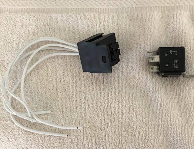

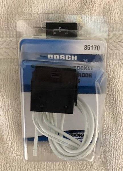

I lucked out....The nearby NAPA store had these:
I do wish though that they didn't have ALL white wires. I guess the shrink wrap will cover since every wire needs to be soldered on and lengthened anyway.

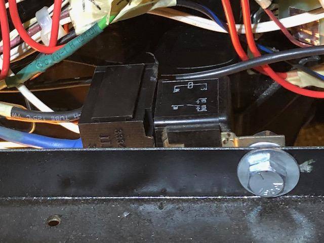

Relay is in and wired as suggested. I was able to drill a hole to mount it flush with the bottom of the dash frame.

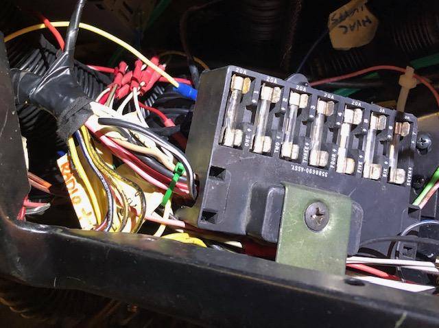

The brain box is back in. All the wires are connected to it but I left the cluster out so I could see all the wiring. I had the Wife at the battery. I wanted her to connect the ground terminal while I looked at the wiring. Call me paranoid but I wanted to have her close so she could pull the terminal if I spotted anything heating up!
No heat, no smoke and no fire!
I did have three wires ran wrong. Two were supposed to be on ACC feed with one to constant power. The auxiliary fuse panel had power after the key was off. I reversed the connections and all was well. I taped up the wiring and secured the fuse box.
