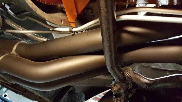

Did your cars have headers?
Headers makes it fun! I had the header loose for removing the trans, that's why the bracket is touching. I completely removed both lines to get them out of the way and reinstalled them after I got the trans fixed. Double duty!

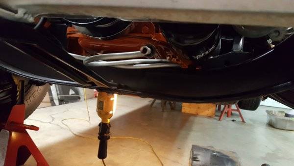

Mine were "right stuff" brand.
They were bent different than factory and actually went in easier than the factory bends.
...although the one through the shift linkage hangs lower because it goes under instead of through.
...and the lines swap to the opposite fitting on the radiator tank/cooler.
Odd, but they work.
