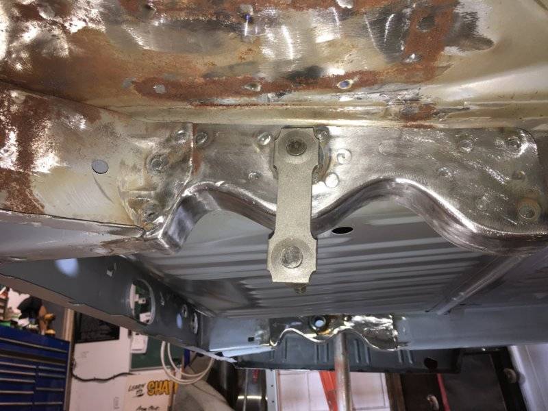

My car is having a ton of sheet metal work done. I installed the front boxes before sending it to the sheet metal guy. I explained that if the rear shackle is installed with the US Car Tool kit it ends up raising the rear of the car - not something I want. So the pin has to be installed at the stock height BUT this requires the frame rail to be modified for the shackle clearance. As you can see, the guy got creative !! Also remover the outer rail and brackets to clean things up.
Stanton. It looks like you went with a 68-70 trunk floor pan too. That’s the route I took also to get the exhaust out the back.

Found this thread; I’m in the process of tackling this right now. This info helped me with the rear shackle install. I’m thinking of removing the existing frame section that holds the original. shackles. Certainly would seem that once you move the shackles, there’s zero need for that section. Reassures me to see that someone else saw it the same way I do.
