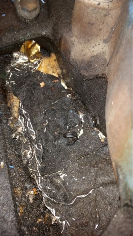

I have a 1973 Dodge Charger I found this on the back side of the manifold above the bell housing any guesses to why it's there and should I leave it.
Never mind I found out why it's there.

Big block Mopar factory intake, the original "air gap".
Guess the engineers figured the gap needed a little help, although I'd question the effectiveness after warm up.

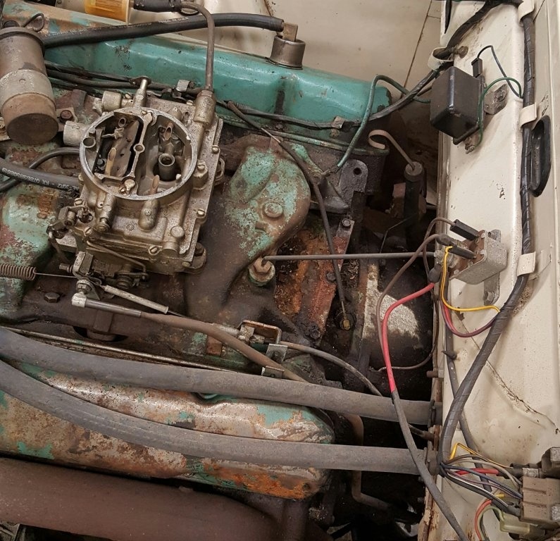

Personally, I have seen some similar pieces of insulation with aluminum covering under big block intake manifolds, I think mid-late 70's. They're usually dirty & soaked with oil in the junkyard. They appear to be an attempt to reduce vapor lock by insulating the intake/carb better from the engine valley. I've only seen a few of these, so they "might" be aftermarket, but I believe they're OEM. What I've seen looks like the picture, but is a bigger piece. I had one of a '77 Cordoba lean burn 400 4bbl.
Weren't they mainly on cars equipped with AC.

So I guess I should just go to Home Depot and get some or should I order the real deal .Im just going to replace this piece not the whole thing.
I think most will leave it out. No big deal. When you replace the valley pan they don't give you one and I don't even think any parts houses carry them.
It's actually a factory part which was installed sporadically. I recall the first time I discovered it during a repair back then, threw it out.
I don't think the depot would have anything rated for high temp that would not burst into flame... I could be wrong though...
Thank you every one for your input it's greatly appreciated.
