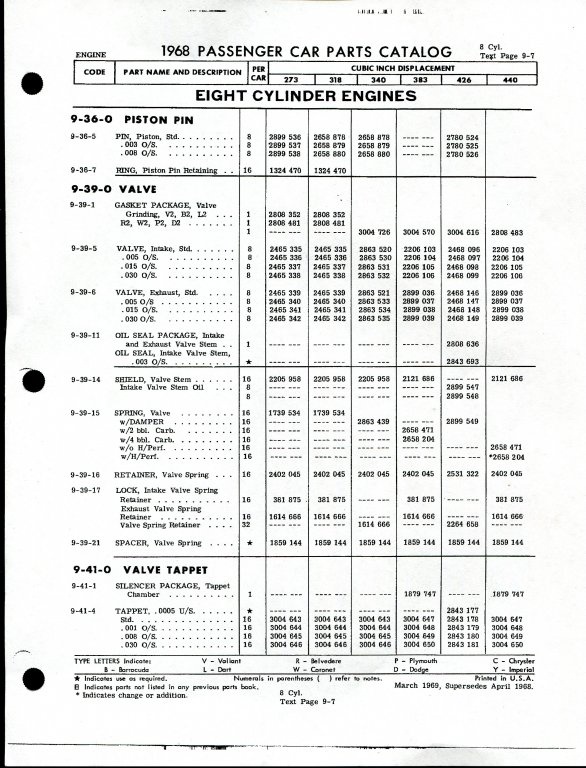

Actually, you're DEAD WRONG. The stuff is referred to as SILENCER PACKAGE, Tappet Chamber and the part number is 1879 747.
Check line 9-41-1 in your parts manual.
Please know what you're talking about before you try and belittle someone who worked as a mechanic for Chrysler/Plymouth and later Dodge when these cars were still in the showroom.
Oh, you don't have a manual?
