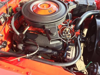

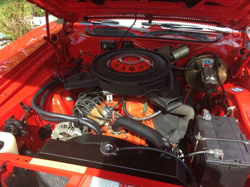

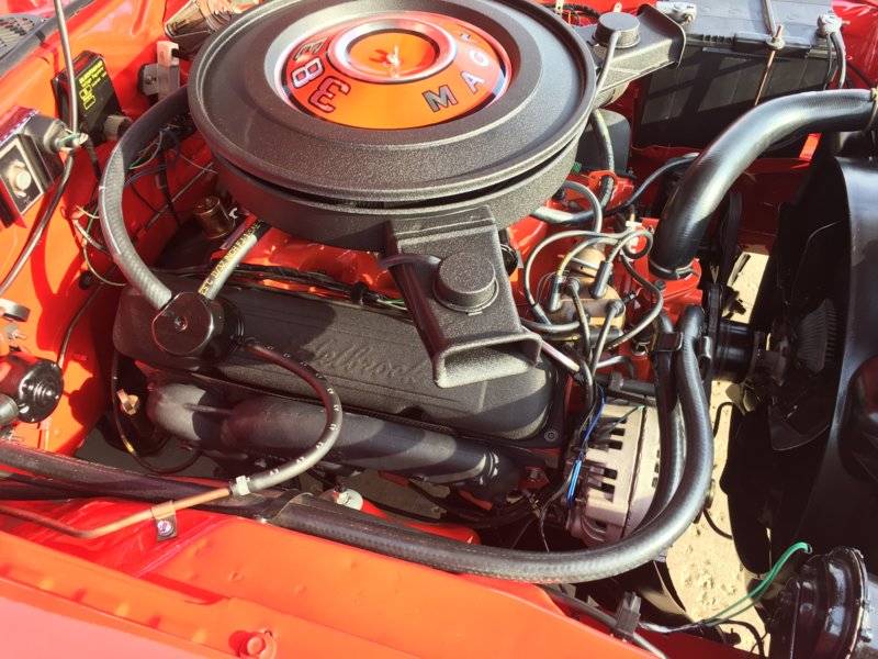

I run it on my numbers 383/432 Stroker
Why
For me it was all about Torque , off idle
I knew my motor on the street , the build I put together , Max HP and Torque would all fall under 5500 Rpms based on most Dyno s I have seen
I wanted to run the RPM but was concerned about the factory one piece kick down linkage , hood clearance (Running the factory dual snorkel was mandatory for me) and coil location etc.
How much am I leaving on the table running the Weiand versus RPM below 5500 Rpms ?
Anyways the Weiand works for everything mentioned
Off idle performance is incredible , well anything below 20-30 mph I can’t keep the 275-60 s hooked up period , will destroy the tires off idle until I lift on the pedal
And I run a pretty tight mostly stock rebuilt torque converter with factory 3:91 Sure Grip
Turbo action valve body in my rebuilt numbers transmission
