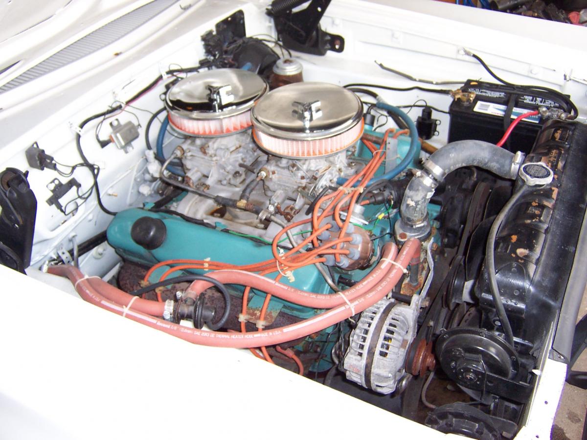

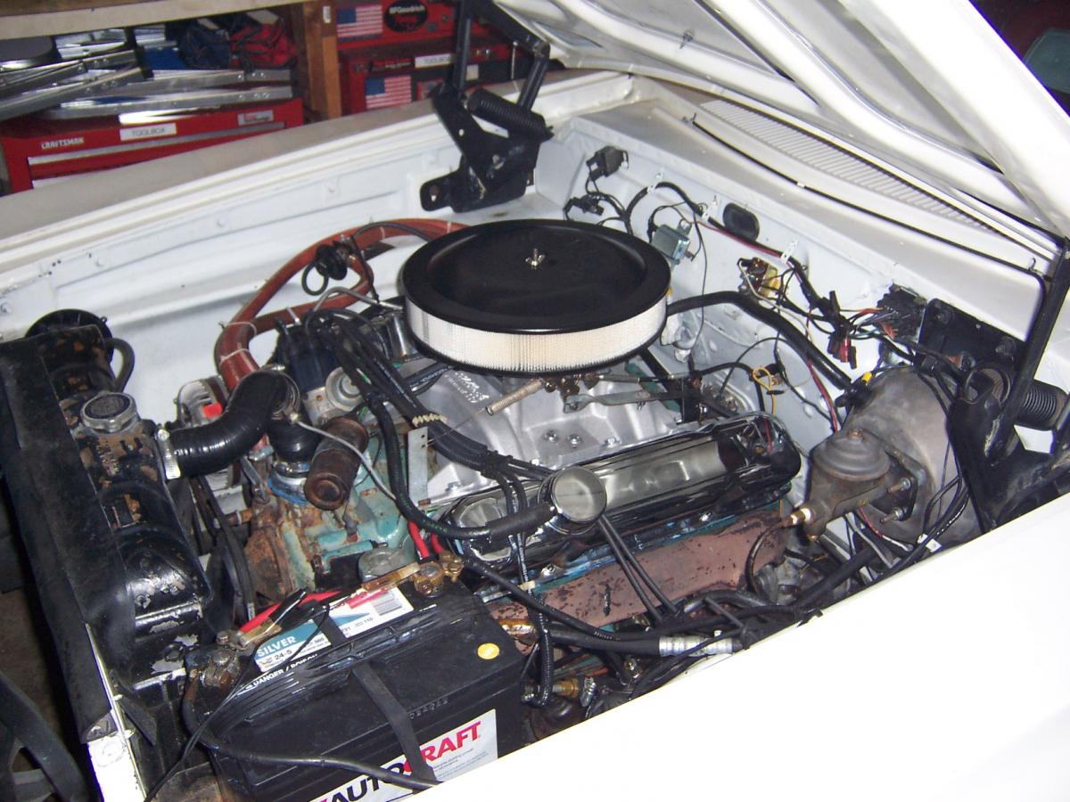

I'm running an Edelbrock Performer now,with a 1" adapter/spacer and an Eddy carb. The filter assembly is obviously a Moroso unit,and I do have room for a 3" filter(2-3/4" on there now). '64's have a slight "bow" in the center of the hood,which helps with clearance;however...the former setup was an Offenhauser/twin AFB setup(with spacers under the carbs) and even with small air cleaners,the front piece just hit the inner hood.
