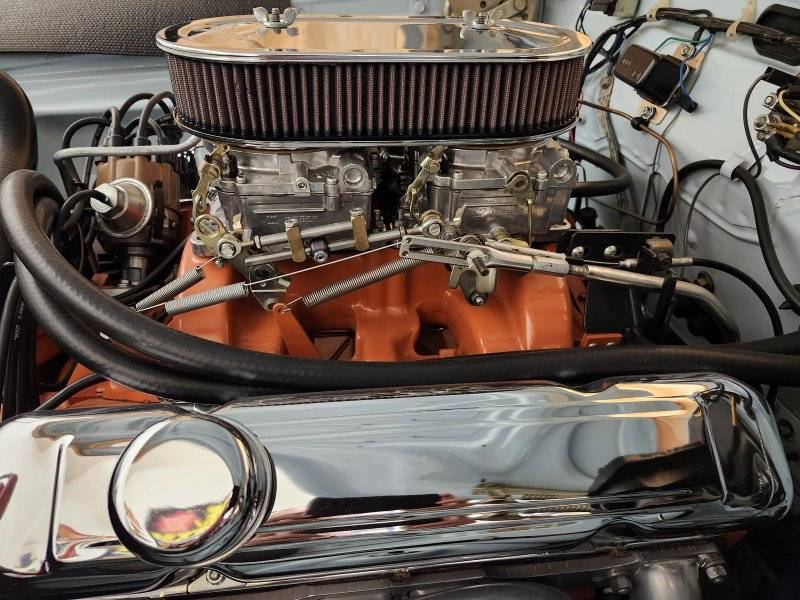

I agree on the $$$$ factor. I am leaning towards the inline 2X4 intake with the repo "football" air cleaners from Vans Auto for the "period correct" engine set up.

Mostly STREET with that "oddball" desire to have the inline 4BBL'S as the period correct set up, back in the day. As a fellow mentioned above, a single 750 cfm with an intake would probably run better AND cheaper. I REALLY wanted the "eye candy" A&A or INDY cross ram (non max wedge) intake & carbs but I no longer can afford that anymore. When that stuff was around $2,500.00 for everything, I thought it was "high" back then.....and as we know now, it's tipping 4 grand. :rolleyes:

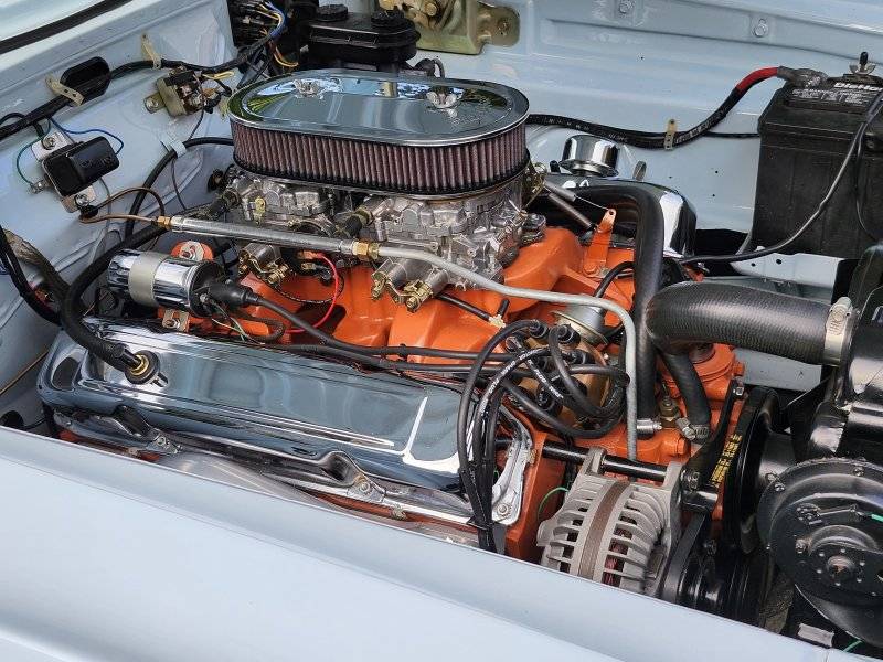

Edelbrock dual quad w/twin AVS II 650’s.
Modified 6 pack
MP-M1-TR-twin Edelbrock 750’s for now.

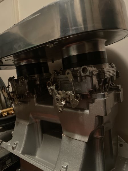

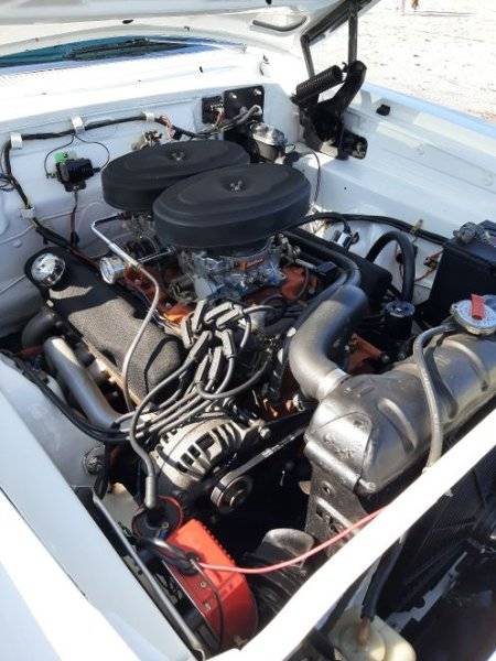

440 6-Pack was 1350 cfm. from the factory. 350 cfm. primary centre carb, plus 2 500 cfm. secondary outboards. It seemed to work OK. Where the problem comes, is when someone is putting together a 2 X 4 setup using two primary carbs without the air velocity-controlled blades over the secondaries. These make the fuel flow dependant on how much air the engine can pump. I had a factory 1962 Chrysler 300H 2 X 4 inline on a 426 Street Wedge in my 1964 Polara 500 convertible. I think the carbs were around 450 cfm. each, and they both had secondary air valves under the boosters. I ran progressive linkage on them. The carbs for factory dual setup had the linkage attachment points at different heights. This allowed the front secondary carb to open faster, so it would be wide open at the same time as the rear primary carb.

Keep in mind that with progressive linkage, first 10% or so of pedal travel only opens primaries on the rear primary carb. That means light acceleration and cruising at up to highway speeds is all done on the one carb. More throttle then starts to progressively open secondary (front) carb primaries. Secondaries are all velocity valve controlled, so no chance of over-carburetion, no bogs, just a lovely dual quad roar.
