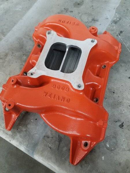

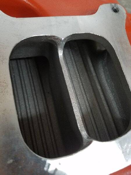

I have a Weiand Action + that I may be listing for sale. Has some custom porting done by Brian Hafliger at IMM Engines in CA and is painted Hemi orange.
