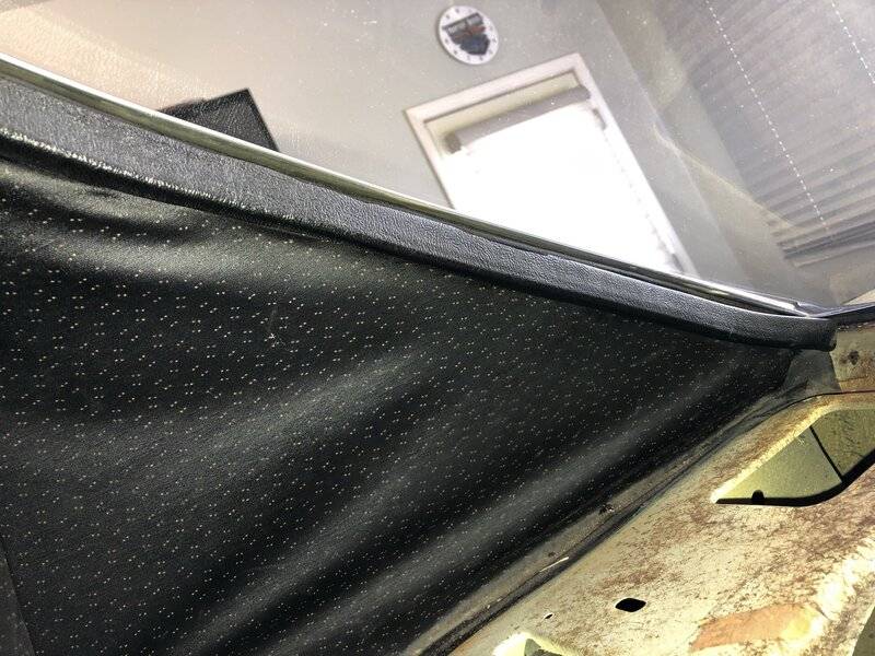

Interior rear window trim

Mine looks exactly like this, with a wrinkled sail panel. I'm not actually sure how to get the trim back into place, and it's not all that pliable. Is it secured with clips or something?
What's the best adhesive to glue the sail panels back down?

Do you know if this will work for the interior rear window trim that’s all one piece going around the top and 2 sides meeting the bottom piece of trim that’s attached to the package tray?
If you’re asking me, I’m sorry but I don’t know how everything gets attached. I’m still waiting to get the rear window trim kit in from Year One that’s still back ordered from June. Once I get that, I should have everything I need, and will take car to the shop that’s doing the headliner installation for me. I don’t have the skills or the desire to attempt it. Perhaps others on this forum can explain how to do the attaching you are asking about. I’ve seen posts elsewhere on here of people doing their own installations that may be helpful answering your questions. You can just try searching “headliner installation” if you haven’t already tried that. Good luck with it.
