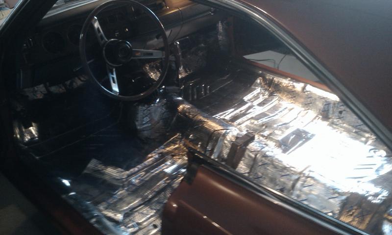

I used the duct insulation that Hemi Rebel mentioned. I found it searching for alternatives and ODZKing used it in his 67 Charger. I asked him if it worked and he said he was happy with it. So i figured I'd give it a try and I put it in my 66 Charger. I'm still in the process of re-doing the interior so I cant give you my opinion on it. But 60 sq ft (4 rolls) was about 80 bucks. Compare that to about 130 bucks for 30 sq ft of dynamat. There are other alternatives to dynamat. But most of them are just roof tar with some foil. At least that is the impression i got. plus most of them smell really bad. while i think dynamat is the best, just my opinion as I have it used before. the duct insulation seems like it will fill the bill at a good price.

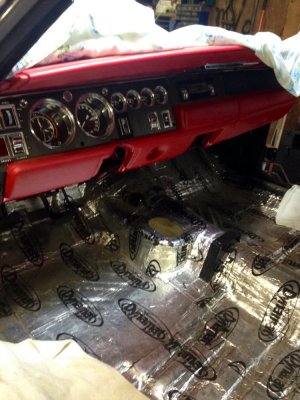

What ever you use make sure it has a good buytle backing and use nothing from home depot or lowes! That stuff is made from tar and will melt in the heat not to mention the smell. I used knownoise its cheaper than dynomat but better in every way.

I use the Rattle trap (made by fatmax). Easy to cut/install, works great. About half the cost of Dynamat, and it is thicker at .080 vs Dynamat @ .067

It is as much about the job you do installing. Prop wash did a nice job there. I used a hardware store knock-off too. It can be too thick making reinstall of belts etc difficult. Do the ceiling if the headliner is out. A must.

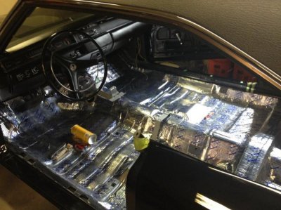

I know this wont be popular but it worked really well and was easy to do. bought a 100 sq ft only cost me $40 at HD Thinking it was this stuff. 3 in 1 heat reflector, sound deadening, moisture control. I will say this, everyone who knows my car before and after now says holy **** we can talk to each other now! Way more quite.
P/S No messy butly crap no rollers all you need is a razor knife and I used the 3m upholstery adhesive from autozone spray can.

The stuff from aircraft spruce I used pretty much everywhere...Roof, undercowl, under carpet, package tray, trunk divider. It's not horribly thick but does need adequate space from any future bolts like the seat belts (those were a pain). I've got some extra is you want me to send you a small square in an envelope that way you can see what it is like in person.
The fatmat stuff I used where ever it sounded "tinny" I'd knock on the floor pan and install squares until it didn't sound that way anymore. Pretty much covered the entire transmission tunnel, firewall, roof, and wheel housings (not the part you can see in the trunk).

I used rattle trap from fatmat too, great stuff.
