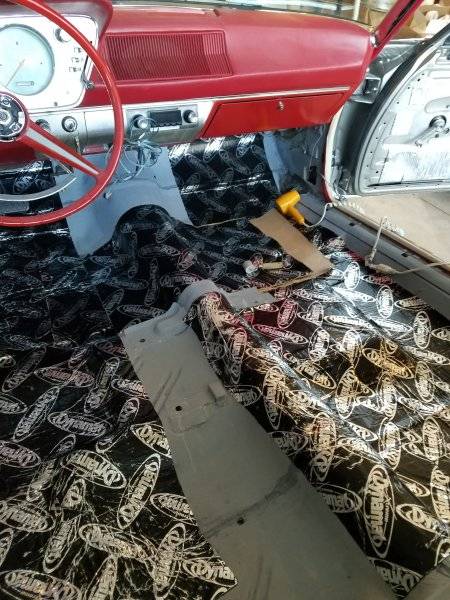

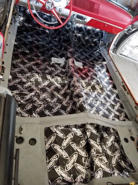

I went with Dynamat, a bit pricier, but maybe 20 bucks over some of the other materials. Think I paid about $150 for a one-box quantity. This was about 6-7 years ago. Some left over material I put in the inside fender areas. Also used HVAC adhesive insulation on the doors. I had some reduction in noise, but my car is a droptop so there's - that, lol.

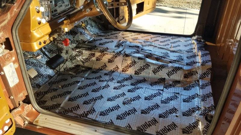

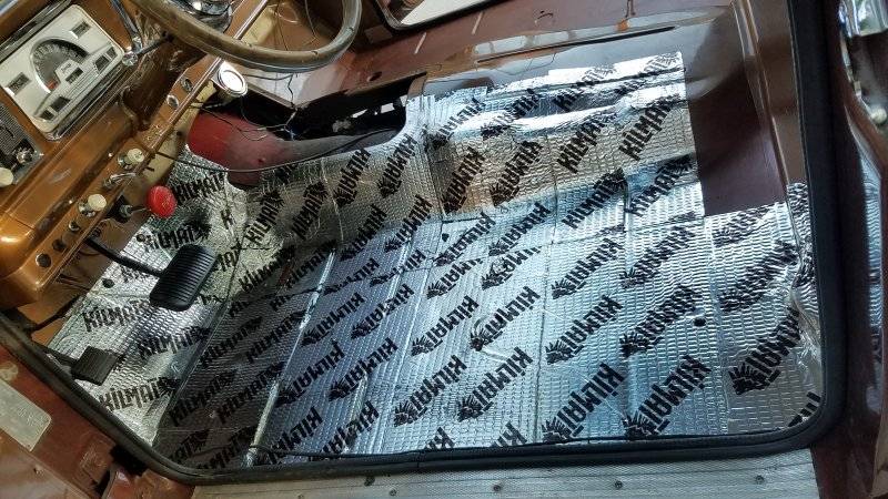

I have nothing but good things to say about Kil Mat. heat is down. Truck is very quiet (67 Jeep Gladiator that sounded like you were in a tin can). Adhesion is no issue. It was done 3 years ago.

Material I used, Dynamat, as others I checked into, have a heavy wax-like coated backing that is peeled away as it is laid in place. The adhesive is a tar-like substance. Set it nice and square at the start as once the stuff is stuck down, there’s no 2nd strike, at least with the stuff I used. I peeled away just enough to get a start then peeled back more of the backing several inches at a time moving along. Use a roller to get it adhered to the floor crevices, tunnel and such before pulling away more of the backing to avoid any folds or bubbles. A few areas I found using a hair dryer helpful.
