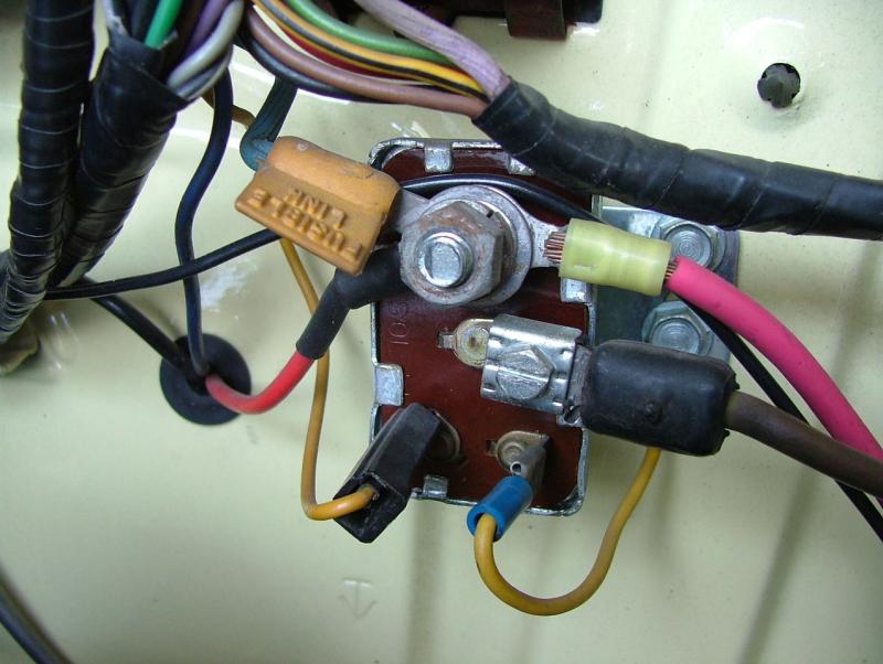

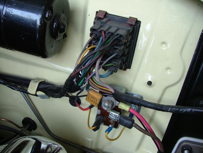

OK here is the latest. (Long) One thing I forgot to mention before is that this car has a pushbutton security switch under the dash added by the PO. You have to push the button and hold it while you turn the key to start. I have learned I definitely have the wrong relay onthis car, it is the type for the automatic trans which is why I have the shortwire to ground, although I don't think this is a problem.
With the key off Ijumped the two exposed terminals with a solid jumper and the starter turnsstrong, did this three times to be sure.
This would appear to indicate that the battery, starter, andmain cables between them work properly.
Next I removed the push-on start terminal that goes into the bulkhead connector, attached my voltmeter, and had my wife turn the key to start WITHOUT pushing the security button - I got a zero reading. Did that also three times with same result. Then we did the same test WITH her pushing the security button and I got a reading of 11 volts. From this it would appear that the security switch is tapped into the start wire. I pushed the terminal back onto the relay and tried the key, the engine turned over fine with security button held in. So it looks like my problem is most likely an intermittent open in the start wire circuit from the ignition switch to the relay caused by:
  • The security switch
  • The ignition switch
  • The bulkhead connector
  • The relay
I'm going to replace the relay first since it is the easiest repair and I want the correct type in there anyway. If I still have trouble I'll probably remove the security switch next although I have no idea how it is wired. What is involved in removing the ignition switch? Any other thoughts?

Frankly, without looking at your security switch, I would suspect either
1....A poor connection at your short ground wire
2...Poor quality security switch or related connections to it.
It COULD be the relay, but frankly, those don't fail often. That one looks pretty clean.
"Other than looks" there is really nothing wrong with that 4 terminal relay.

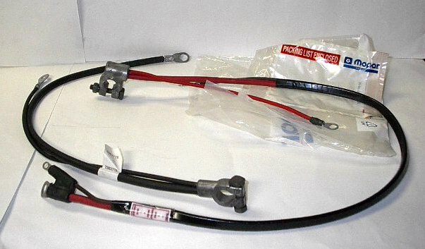

Those originally were molded in with the battery cable. I've seen them break, internally, in the molded connector
...........like this one.........
I replaced the ignition switch for no reason. Found to be bulkhead connector. Remove each of the three banks VERY carefully and spray with electrical contact cleaner till it runs clear. Empty the can if needed. Reinstall.
