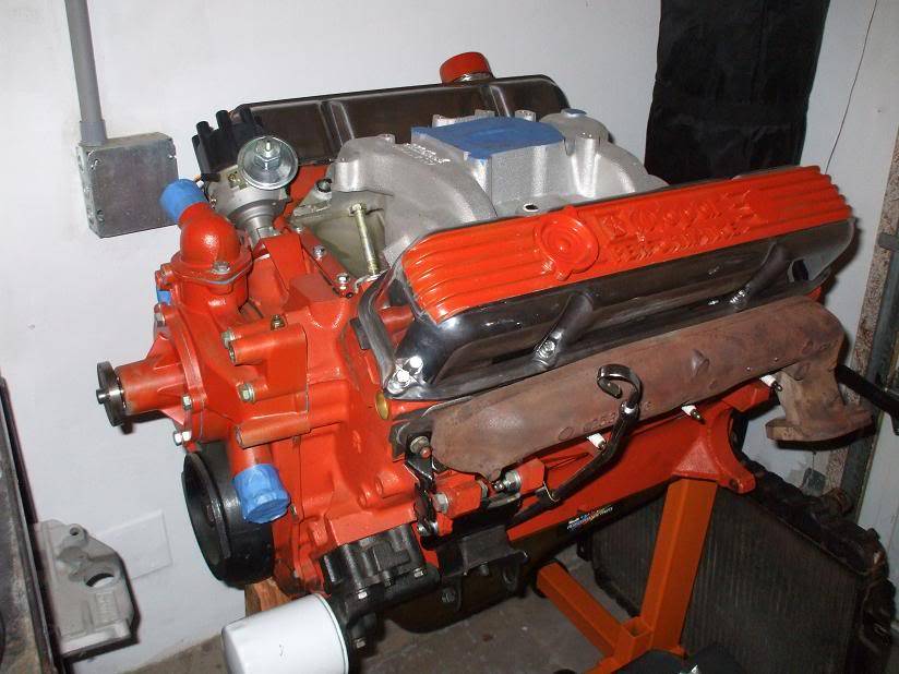

I internally balanced the MP 4" cast crank in my 340. It IS lighter than a forged crank and spins up very quick.
