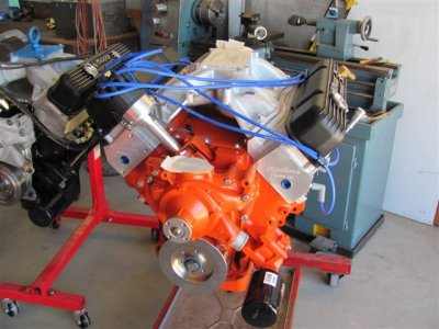

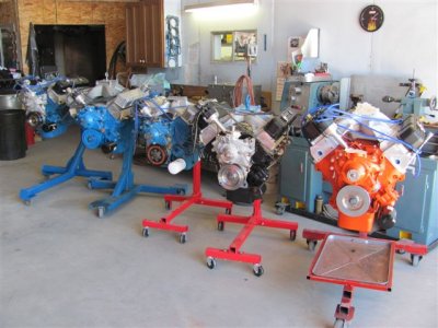

Jim and Cody Laroy have been building some awesome bigblocks this spring and summer, including mine.
He sent me this picture, I thought everyone would appreciate.
I can't thank Jim enough for everything he has done on my motor including answering all my dumb questions like: "Is it sacrilegious to paint a 440 orange?" and his answer: "If you want your engine painted orange, your going to get it painted orange!" LOL
Impressive numbers of high quality, highly reliable, naturally aspirated Chrysler big blocks built by Jim and Cody.

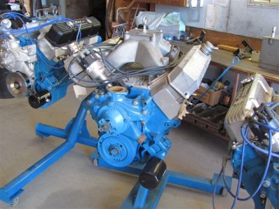

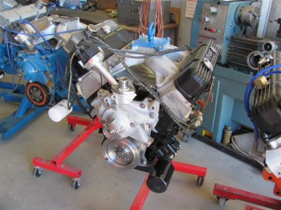

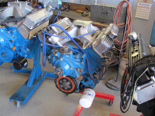

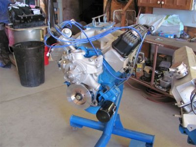

Left to right in lineup:
  • 496/440, Solid street roller, RPM heads, Edelbrock Torker II. ?TQ/?HP
  • Pop's 446/440, stock forged crank, stock rods, 1968 Racer Brown Roller, Indy EZ heads, Indy 3X intake, 549 TQ @ 5,500 RPM/ 658 HP @ 6600 RPM
  • 451/400, Solid Street Roller, Factory 906 Iron heads, M1 single plane, 520 TQ/ 580 HP
  • 505/440, Solid Street roller, Edelbrock RPM heads Torker II intake, 626 TQ/657 HP
  • 446/440, Custom Hyd flat tappet, Edelbrock Victor heads, RPM performer intake, 566TQ @ 3,700 RPM/ 544HP @ 5,500-6,000 RPM
