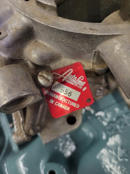

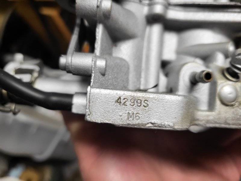

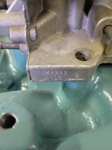

I would stay away from any of the knockoffs, they are inexpensive for a reason.
Just got a good look at it, it's a 4200S. They were used '64 to '67 on 383's.
