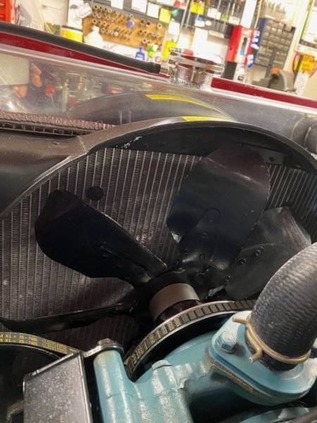

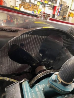

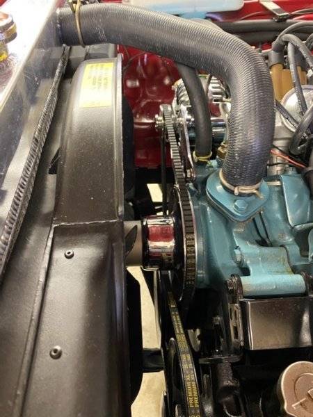

Say Dave here’s two shots of fan and shroud.
4B543C15-1803-4C26-A77A-6C493781DDD2.jpeg 5E3C37E8-D350-4940-9EB6-C268698B88FF.jpeg
6 blade with no clutch? I think I'd swap that for a 7 blade with more pitch (I use one of these) and get a 1/2" shorter spacer, to put the blades about 1/3 into the shroud. Looks like you might also have an A/T cooler in front of the radiator? Should be spaced away from the radiator core up to an inch +-.
