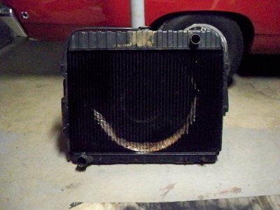

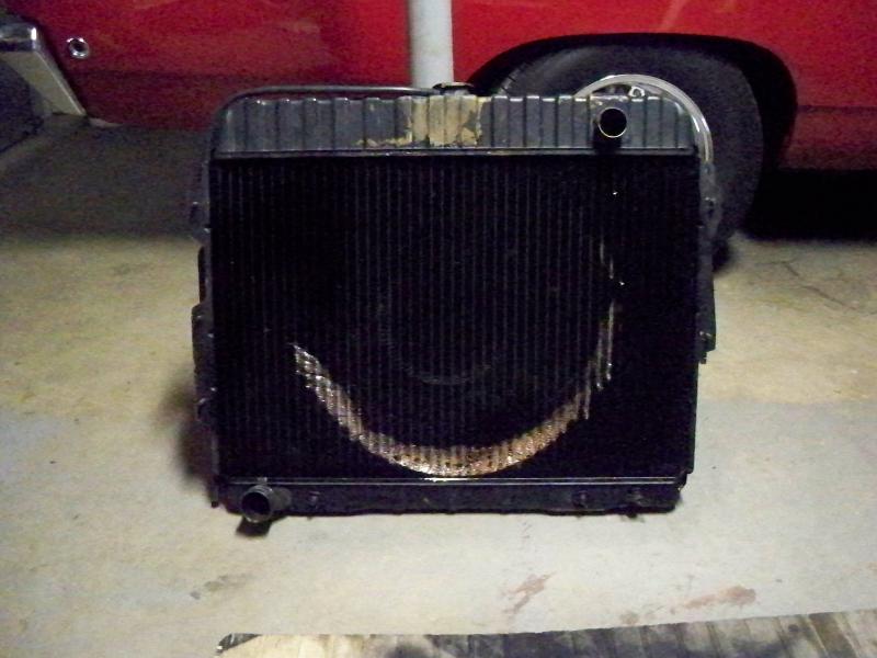

Thanks for all the help. This is what my radiator looks like now.
Ken
Ken
Looks to me like the clutch made contact too. Sure the motor mounts are good? Maybe the water pump bearings are shot?
Your shroud looks pretty narrow so you have to be fairlyclose for it to work properly. I had 1/4" with stock fan/clutch no shroud,I changed to a shorter clutch now I have 3/4-1"
I agree with the others about checking the motor mounts. Jack the motor up to see if the mounts separate.
Flex fans flatten at speed and are widest at rest. I,m betting bad motor mount or loose k frame.A broken trans mount could also be suspect as it only hit the bottom like the trans slammed on a bump.
thanks for all the help. I'll be checking everything mentioned this weekend before installing a new radiator and fan.
